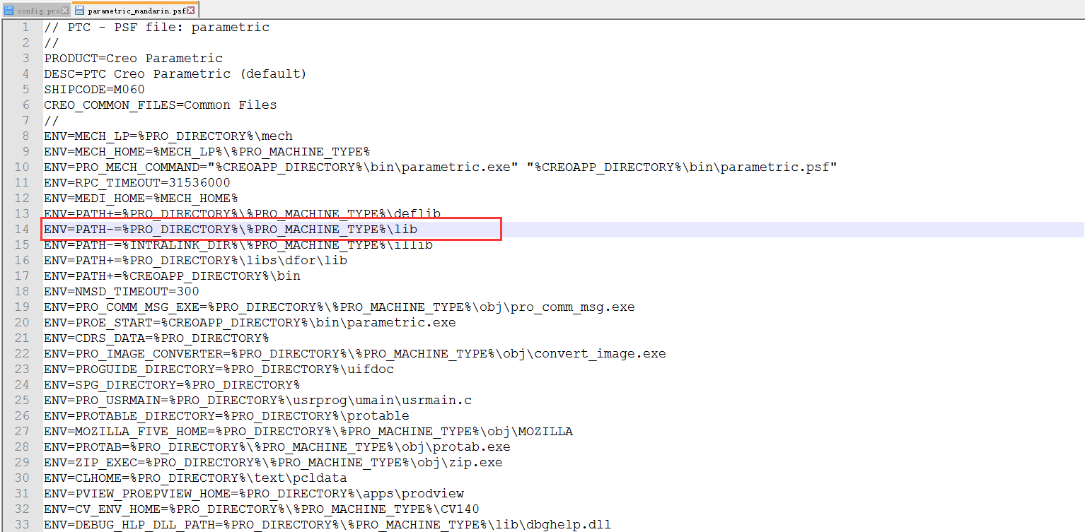

how to define my vars similar to the PRO_DIRECTORY,like MY_DEMO?

to define requested variable, add following line at the end of psf file.
ENV=CONFIG_PATH=D:\DEMO
Then your config.pro can contain following lines
template_solidpart %CONFIG_PATH%\startup\iso_solidpart_default.prt
-OR-
template_solidpart $CONFIG_PATH\startup\iso_solidpart_default.prt

please describe what do you want to achieve. I do not understand why you are pointing into psf file.

i want to define some enviroment vars to define the path for the config.pro,so that i can put the config.pro everywhere,
for example,i define the system enviroment vars CONFIG_PATH D:\DEMO
and i modify the config.pro like this:

You can define your own environment settings in the proe.bat file or call your own file from a modified proe.bat file.
The PSF file should not be changed.

can you give me a demo for how to modify the bat files?i used the creo3,i can't find the proe.bat files
November 11, 2016
look for parametric.bat file.
