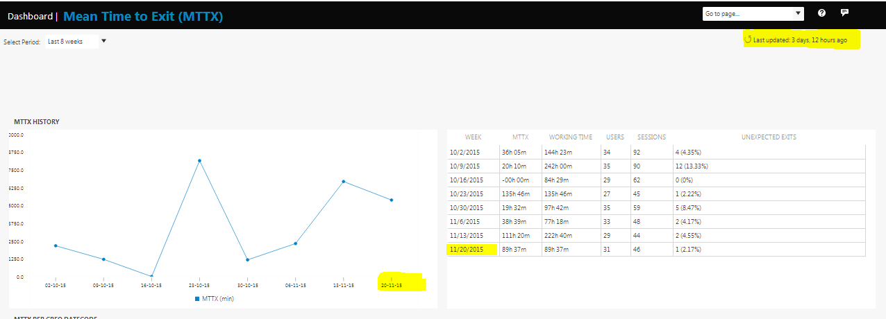

After some weeks using PA for Creo I would like to discuss some hints and also have further clarifications.
First of all, what cause me a headache every day is MTTX history chart.
What I would expect it's not to have data of last 4 weeks changed every single day.
Attached are two pictures taken last two Fridays at the same exact time in the evening.
As you can see, the starting day of the week is different and the first picture has 7 rows instead of 8 (selected period is last 8 weeks).
In this way every day the progress of the chart varies and it becomes difficult to follow the trend.
Another issue concerns the MTTX time.
I know that a number divided by 0 is equal to 0, but I think that, if there are no unexpected exits, the MTTX time should be equal to the working time otherwise you'll see a chart like second picture, where it seems that Creo no longer works for any user.

Last but not least: many data sessions are not appearing in Session Counts dashboard even if they are present in SentFiles folder (see lat few days in attached picture).

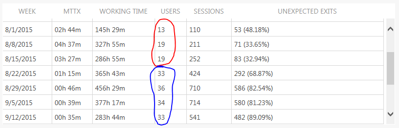

Without the ability to correlate user (username or computer name) to a session, I find the whole thing rather useless.  I have no interest in maintaining a custom look-up chart between UID's, UUID's, users, and computers.
I do agree with your comment about zero unexpected exits.  These should be the highest points on the chart, not the lowest.
...if there are no unexpected exits, the MTTX time should be equal to the working time otherwise you'll see a chart like second picture, where it seems that Creo no longer works for any user.
It does look like something changed with how the data is being reported or processed by PTC.  We're suddenly showing twice the number of users:
The exit percentages are also completely unrealistic.  (Things are working good right now.  I would be getting a non-stop earful if we really were crashing this much!)
TomU
Oct 19, 2015 4:18 PM UTC
Correction on the last two point above.  I think the increase in users is due to the Windchill CAD workers being included.  I'm guessing the increase in MTTX is due to how the CAD workers terminate Creo when done.  (The sessions are terminated after being idle for a certain period of time.)  Looks like I either need to figure out a way to separate the CAD worker sessions from the "normal user" sessions or just shut off reporting on the CAD workers all together.

MarcoTosin
Nov 23, 2015 2:38 PM UTC
It's been three days since nothing new came in my dashboard.
Does anyone else have the same issue?
Marco
MarcoTosin
Nov 27, 2015 3:34 PM UTC
I have got an answer from TS about above comment:
... As it seems no session recorded after last Sunday is showing in the dashboards.
It is a general issue, not only affecting you, but other customers as well.
Our own data at PTC does not show newer sessions either...
Marco
MarcoTosin
Dec 1, 2015 8:44 AM UTC
Sessions data are back from last Thursday (11/26).
Marco
