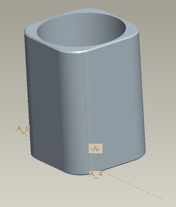

Your Extrude 1 has two sketched features, one of which is a construction circle. If you change it to geometry you will see datum A.Capture.JPG

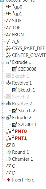

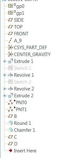

Just so we are on the level...
I have unsuppressed every object.
I have expanded every branch.
I have done all these things.
I even looked throughout the drawing for the part to see if someone had previously generated a drawing entity named "A" that is preventing the part from having the same name.
What I ultimately did was delete features in the tree until I was allowed to create a datum/feature with the name "A."
It ended up being the in the "Extrude 1."

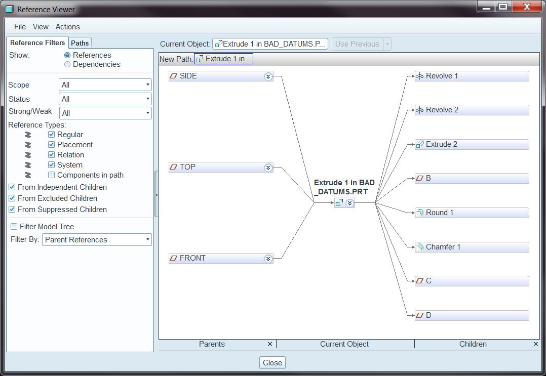

But even though I searched the reference viewer, I find no mention of a feature or reference named "A."
It was a simple enough part, I just deleted the initial extrude and rebuilt the model, but I would like to know what I'm missing to solve future problems.
There is a cross section "A," but even though I may delete it, I still can't create a feature named "A."
I checked all the dimensional names and none of them are "A."
I was really hoping that there is a utility for cleaning part files.
I'm very familiar with CATIA V5 and it has a built in utility called CATDUA V5 that cleans the file of check sum errors, faulty data, bad links, etc.

It's possible that an axis is created that is part of the feature and the axis was assigned the name "A".
