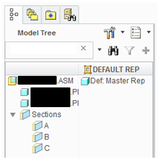

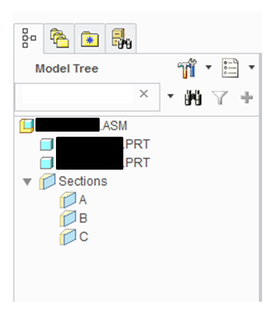

Default Tree Column Configuration
Is there a way to make the 'Current Rep' tree column NOT display every time a rep is changed in an assembly? When I open a Master Rep, the model tree looks like the first image. Then, when the rep is changed (to default rep, for example) the tree column 'Current Rep' is displayed. Is there a way to turn this feature off and always have just the original column display no matter what rep is displayed? I know I can go into Settings>Tree Columns, but I am wanting a config setting that will always hide it.

Graham,
try to use the following config.pro option:
simprep_column_display manual
See https://support.ptc.com/appserver/cs/view/solution.jsp?n=CS183479
