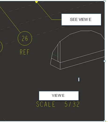

Does anybody know what settings (dtl/config/format file) controls the format used for detail view notations in a drawing?
I have attached two images one from a user's PC with the notation we use and one from a user's PC where the notation is very different.

We had a manager one time demand no scales displayed on the drawings so we changed the scale note size to .001. You still get the SECTION A-A part but the scale note is just a little dot. Horrible work-around but it met the demand.

I don’t know of any way to change/eliminate the view/scale note automatically, but you can certainly delete it. Just pick on the note and hit ‘Delete’.

I submitted a Product Enhancement Request to allow the view_note option to match the detail_circle_note_text. So now we need votes to move it up the ladder for consideration. I know this seems trivial but I'm tired of having to change the text every time I create a detailed view. It creates a needless opportunity for a checker comment if I forget to change it.

I am not sure exactly what you are asking for. I can tell you that the view
name text CAN be edited to add information under it.
