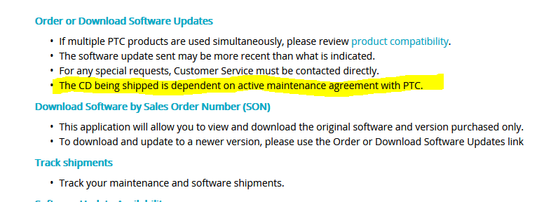

Does that require a maintenance contract?
September 27, 2016
1st, I looked and saw no VB reference in my desk references from Pro/Jr days.
I think we had perpetual rights to previous releases.  This could change some day as SW is forcing "subscriptions" onto people to go into most of their account including downloads (which NEVER worked for me, and SW support failed 4 times to correct)...  what was I sayin'    oh yea, I order all new releases on DVD and I downloaded almost everything I may ever need.  It is a huge collection that took weeks to download onto a dedicated drive.  My V19 disks saved my bacon a few years back.
Try here PTC: https://support.ptc.com/appserver/cs/software_update/swupdate.jsp
...It looks like physical media is the limitation.  Of course, the older version sites are hit and miss.
I give PTC kudos for including shipment of physical media without a fuss.  You practically have to beg them out of SW's hands.  And 2015 sp5 doesn't exist on media, believe it or not.  It wasn't worth their time.  This is why PTC got my maintenance dollar and SW didn't.
