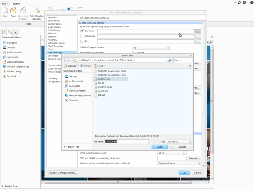

Under the options for Data Exchange, the default workflow (Open or Import) as well as existing format specific profiles can be controlled. Additionally, new profiles can be created and modified with the help of the Import Profile Editor.

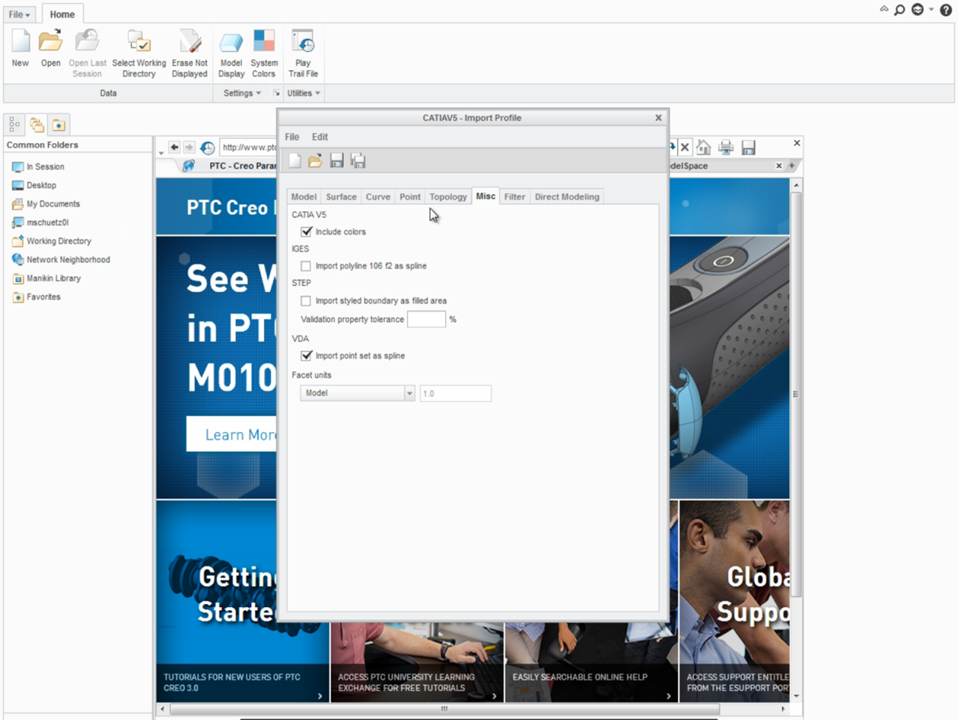

A look at the options under the Import Profile Editor, in this case with CATIA V5
Once defined, these profiles automatically control which information get into session without any additional dialogue or user interaction.

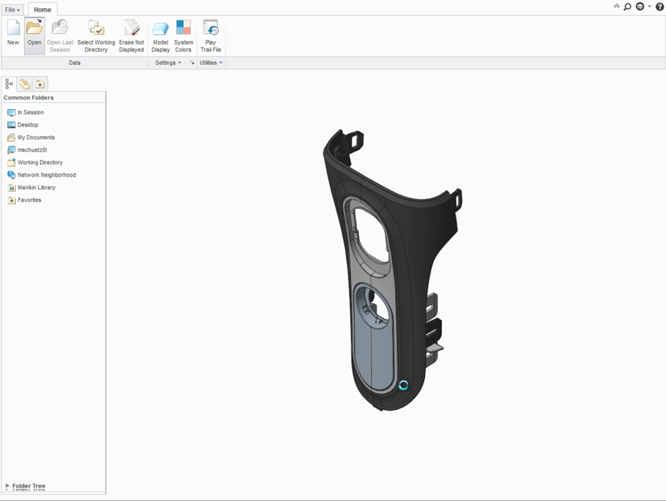

After the data is opened, users can start to work with non-Creo assemblies right away.
A look at a non-native part opened in PTC Creo with Unite Technology
