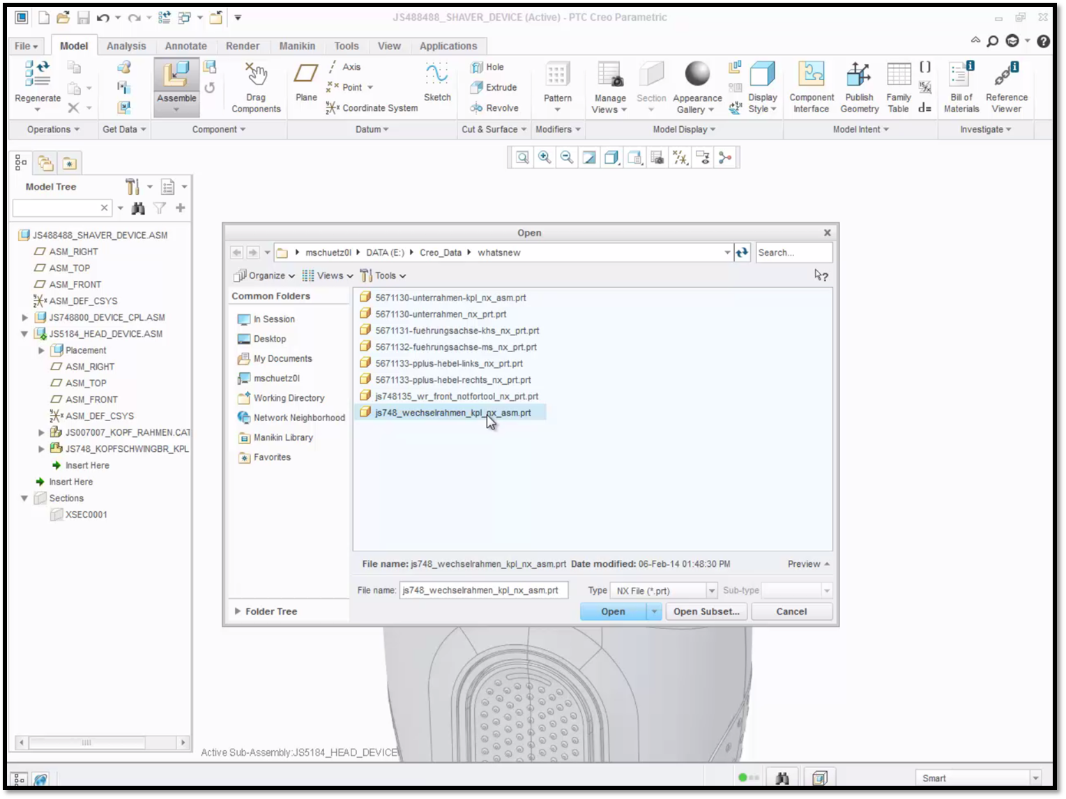

CATIA, SolidWorks and NX parts can be opened and referenced in PTC Creo. And format specific profiles and templates can load foreign data as easy as PTC Creo data. Once defined, profiles automatically control which information gets into sessions without any additional dialogues or user interaction. The benefit is that users can start to position foreign assemblies right away. Users can distinguish the different formats in the model tree by the individual file icons and file extensions. Once a user begins work, PTC Creo automatically tracks changes made to the foreign data in their native systems to keep the designs up to date. To begin the process, open the Model tab, click Assemble, select your item and click Open.
In this example, an NX file is opened in the same manner as a PTC Creo file.

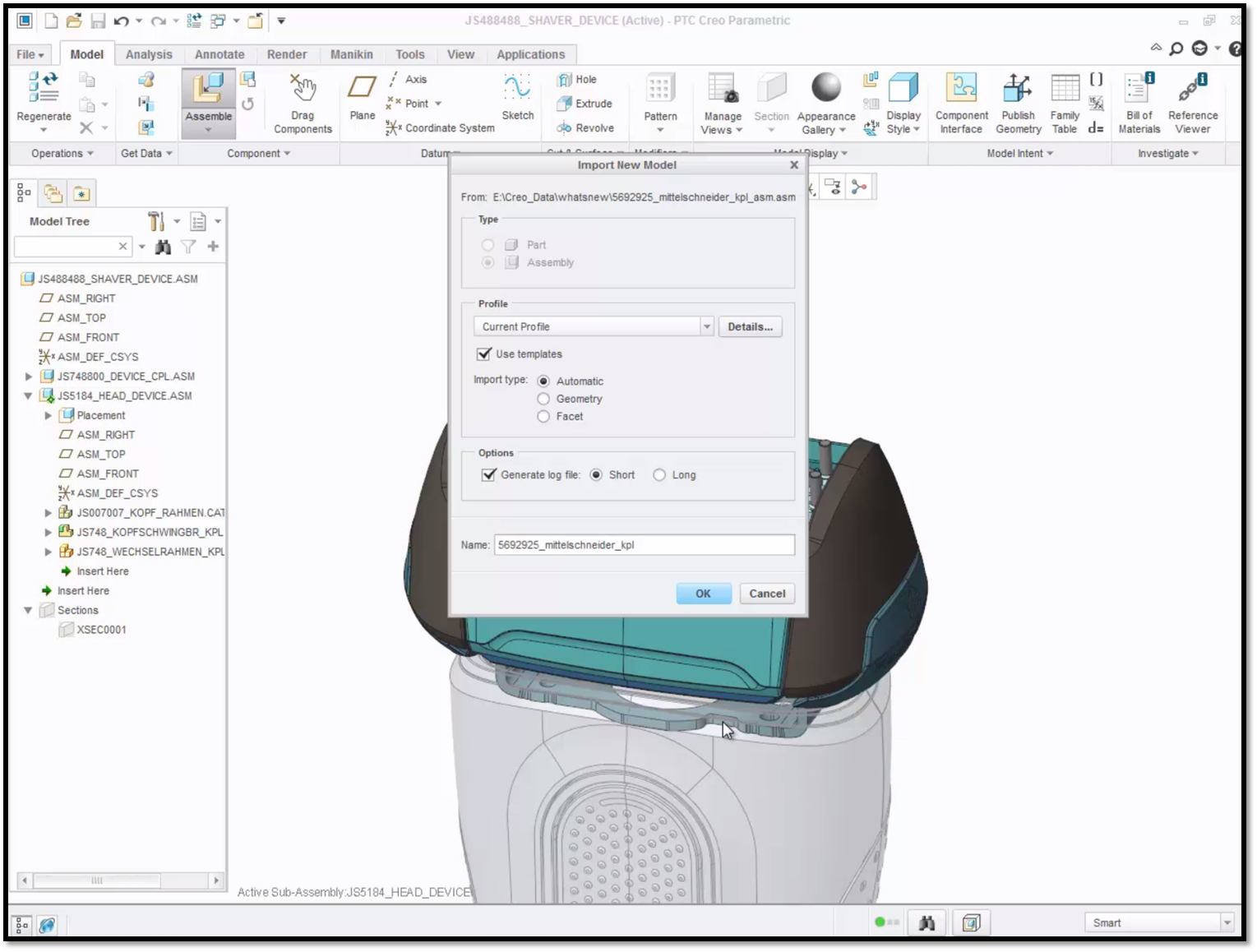

PTC Creo 3.0 also enables users to import SolidEdge parts and assemblies. During the import process of SolidEdge data, the user has the ability to decide which information to import or to simply use the standard template for foreign data. This follows the same process as before with one exception. Once you select your item, click Import. The Import New Model dialogue box will appear for you to edit. Click OK to save your changes. The imported geometry can easily be referenced using all available assembly constraints. Ultimately, PTC Creo 3.0 provides a single platform where all major CAD formats can be integrated, developed into multi-CAD product designs and validated.
The name of the new model was changed to match the original file name.
