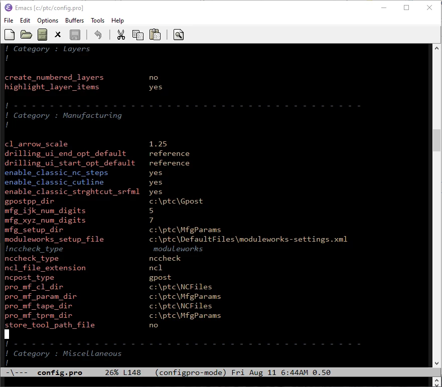

KenFarley
August 11, 2023
I second that recommendation. With the data files available from that site I was able to customize my editor to use colors to differentiate between nominal and hidden options, as shown in the attached image. Emacs configpro.png
