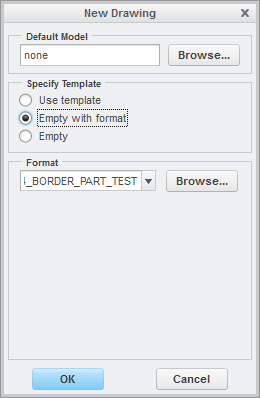

Please could somebody advise how to ensure that in the "Specify Template" section below the "Empty with format" radio button is selected by default?
Many thanks,
Andy

Andy,
In Creo 2.0 you can create a mapkey using File > Options > Environment > Mapkeys
Here you can create a mapkey to start a new drawing with required options.

No config option for this, yes you can use a mapkey.

Thanks Mahesh. How do you use a mapkey for this please? Can they be set to autotrigger somehow?
