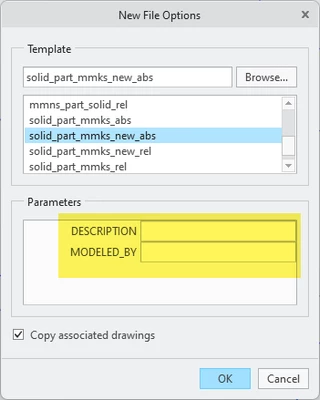

I am looking for a drawing format for academic use. mm, ISO, 3rd angle.
I'm looking for format that templates of standard part and assembly template will be linked to parameters (DESIGND_BY and DESCRIPTION)

@MartinHanak I appreciate your willingness to help.
I'd like to use these two parameters in drawing format.

please read https://support.ptc.com/help/creo/creo_pma/r10.0/usascii/index.html#page/detail/to_retrieve_model_parameters_in_drawing_using_format.html#
-AND-
watch https://www.youtube.com/watch?v=lGT85r_f8Dw video (start at 10:00).

I'm afraid you'll have to create them yourself.

I found some formats and templates in the folder: C:\Program Files\PTC\Creo ##.#.#.#\Common Files\creo_standards\formats.
Unfortunately, no format from what I found there or in the subfolder is suitable and is not linked to a standard part or assembly.
This makes me wonder why the default standard parts and assemblies have parameters that aren't associated with anything.
