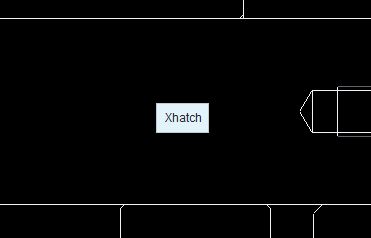

And I noticed if you pause with the mouse over you do get hover tip. Even though you can see no visible xhatch.

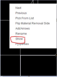

If I understand what you are asking, if on Layout in the ribbon, you click the view once where the hatch would be (nothing will actually highlight) but then right click and you get this menu, and you see Show and Properties.
Inoram14-AlexandriteAnswer

Thanks Matt. This one worked in selecting the xhatch.
