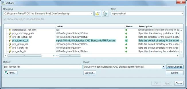

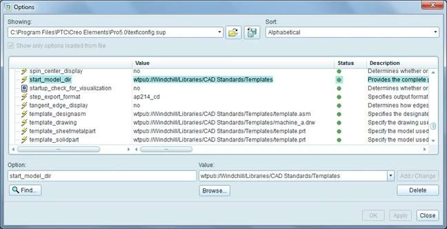

Try setting the config.pro options by actually browsing to the folder. You should end up with something like “wtpub://<server name=">/<product or=" library=">/Subfolder”
“pro_format_dir” will tell Creo where to find formats. “pro_format_dir” is used for templates (both parts, assemblies, and drawings).
Keep in mind that whatever name you give the server when you register it in Creo will be used as part of this path, so if the config is shared it’s important that everyone name the server the same (ex. “Windchill”).

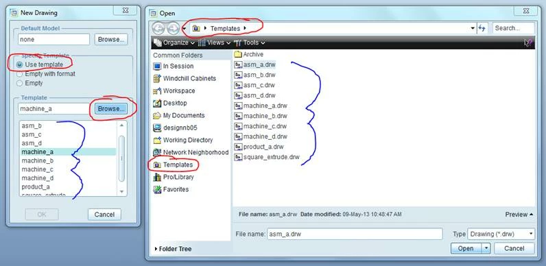

Once these are set, any time the system needs a format or template, it will automatically look in the proper folder.
[cid:image006.jpg@01D039B9.71039EA0]

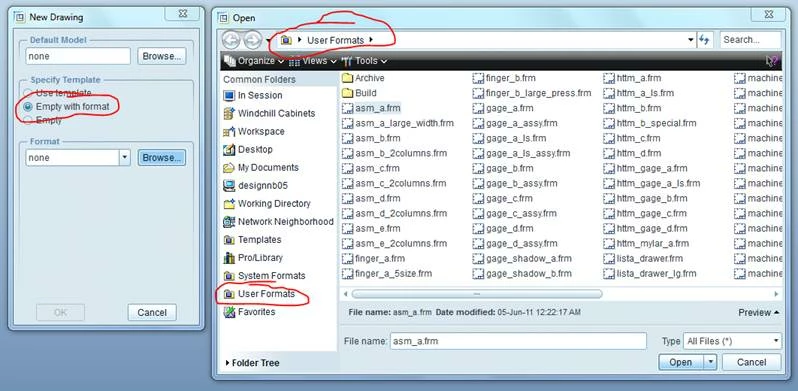

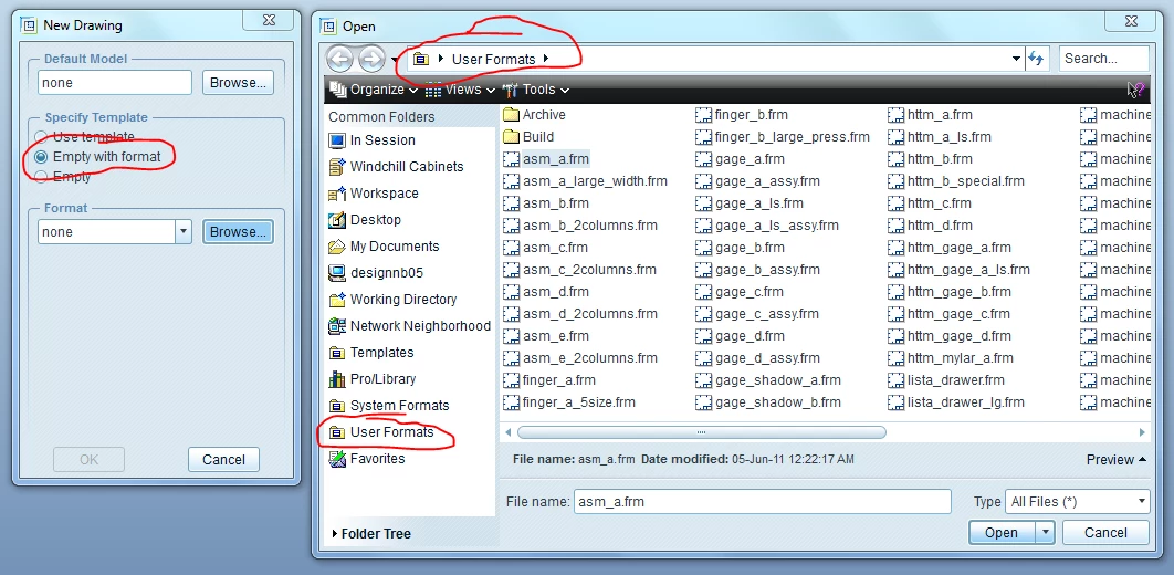

Unlike the templates list, the formats dropdown list will only show formats loaded into session. Fortunately the “Browse” button will still take you directly to the formats directory (once set correctly).
