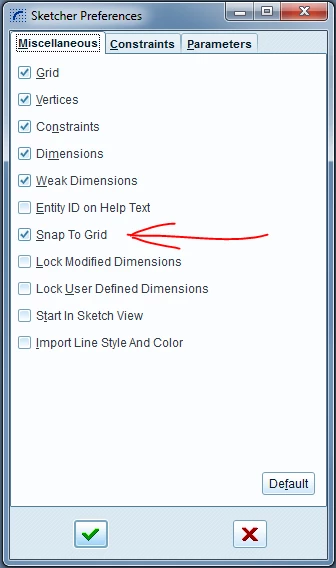

Sep 11, 2012 4:53 PM UTC
You don't have to go to config.pro but you do have to go to Options:
File/Options/Sketcher/Sketcher Grid/Snap to Grid
Yes, it is about the most boneheaded basic Detail option one could think of in any of the ProE/WF/Creo implementations. Creo in fact brought this to a whole new level of inconvenient places since they removed the "Environment" window and replaced it with "Options".
What in the heck does Sketcher have to do with a drafting grid anyway? (!)

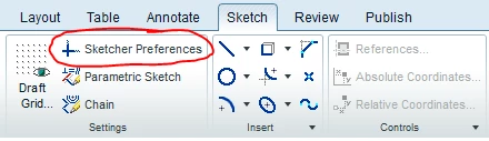

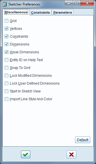

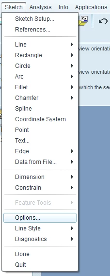

Maybe I'm missing something, but when in sketcher (not in a drawing), you just go to "Sketch/Options" and select "Grid".
[cid:image001.png@01CD903B.1BB5C560] [cid:image002.png@01CD903B.1BB5C560]
When in a drawing, select “Sketcher Preferences” on the “Sketch” tab (WF5)
[cid:image003.png@01CD903B.B2C27110]
[cid:image004.png@01CD903B.B2C27110]

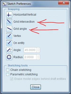

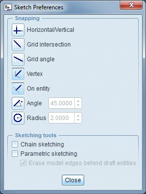

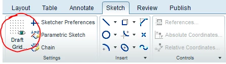

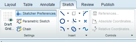

TomU
Sep 11, 2012 11:04 PM UTC
In WF5 I can turn on and off both the grid and the snapping in both part/assembly mode as well as drawing mode without ever touching a config.pro option.
I'm not sure if my pictures are coming through, but assuming they are....
In sketcher, this turns the grid on and off:
[cid:image001.png@01CD904F.716EDF00]
In sketcher, this turns the snap to grid on and off:
[cid:image002.png@01CD904F.DDD56BA0]
In drawings, this turn the grid on and off:
[cid:image003.png@01CD904F.DDD56BA0]
In drawings, this turns the snap to grid on and off:
[cid:image004.png@01CD904F.DDD56BA0]
[cid:image005.png@01CD9050.359BD180]
Sep 12, 2012 1:07 AM UTC
Tom, thanks... your pictures come through better in emails than they do on the forum.
Creo is definitely different. That "Sketcher Preference" window is not available in the model or assembly ribbon. You don't have to access config.pro specifically, but the option window that has nearly all the environment setup selections put in one place (file/options).
You did highlight one I was not yet aware of. In the drawing, the Sketcher Preference dialog (notice how they are named the same but have different interfaces) where they call "Grid Snap" "Grid Intersection". <= even more unneccesary confusion! This one will be more useful in general while working on drawings.
I am not fully versed on WF and did not use the WF5 ribbon adaptation. I am old school from 2000i. I did find the old Environment menu in Creo when editing symbols of all things. That is where we use to set snap to grid.
So now we have 3 places you can change the grid snap. Odd however is that the drawing sketcher Grid Intersection does not toggle the config.pro or Sketcher option settings. It seems to be a local toggle only, which is fine by me.
