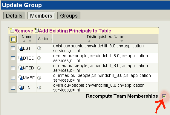

    September 30, 2010
    In the Update Group dialog there used to be a pick for recomputing the team membership.
    In 9.1 I no longer see it. Where did this go?
