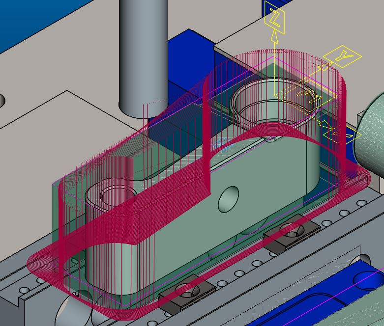

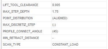

Jul 6, 2015 3:17 PM UTC

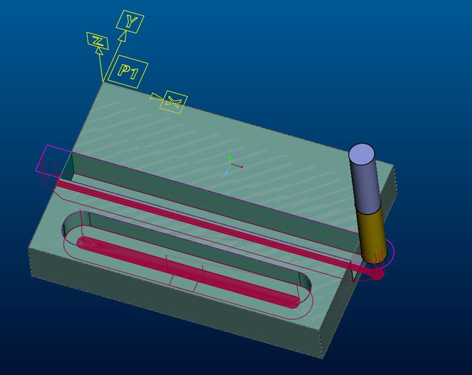

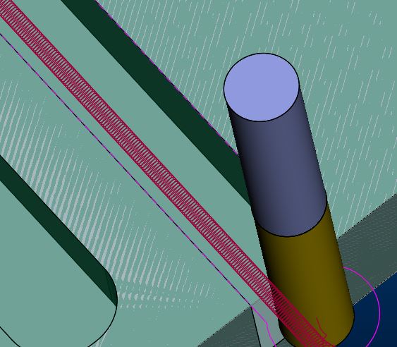

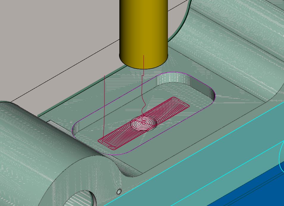

I have been using the constant load option a lot recently and have gotten good results. I visited the Creo NC Booth at PTC live and was made aware of two parameters that help.
MIN_RETRACT_DISTANCE  is actually the distance that you desire between retracts. if you want the tool to stay down set this to a value larger than the area or (part) that you are machining.
LIFT_TOOL_CLEARANCE  is a value to lift the tool when not in cut (like a small retract).
Jul 7, 2015 1:47 PM UTC
Todd,
I have been playing with those parameters and still get a retract at the wall but not all the time ? I have a pocket similar to your second picture that I am trying to cut. It is a .125 deep by .500 wide  by 3 inch long pocket but the cutter still retracts back to z zero for a ways then settles down and behaves as expected. I guess this is a work in progress I can't figure it out.  I used the parameters similar to what you have in your picture but that must have been for the one that retracted all the time.
11-Garnet
Jul 7, 2015 4:40 PM UTC
snguyen1-VisitorAuthor
Jul 7, 2015 2:20 PM UTC

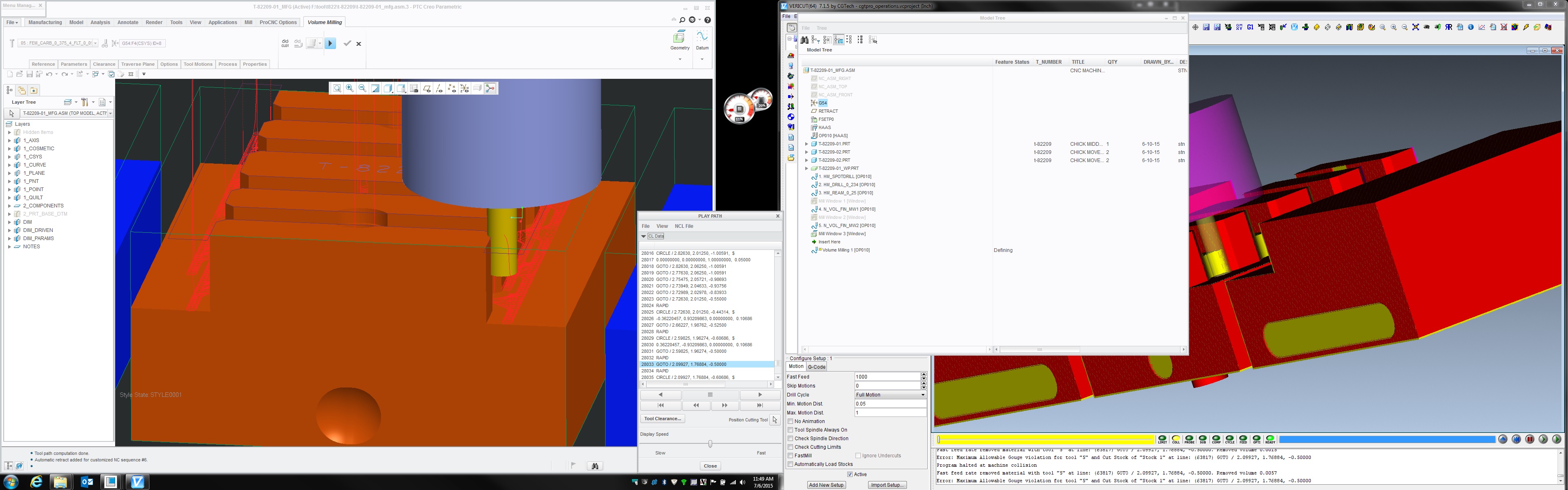

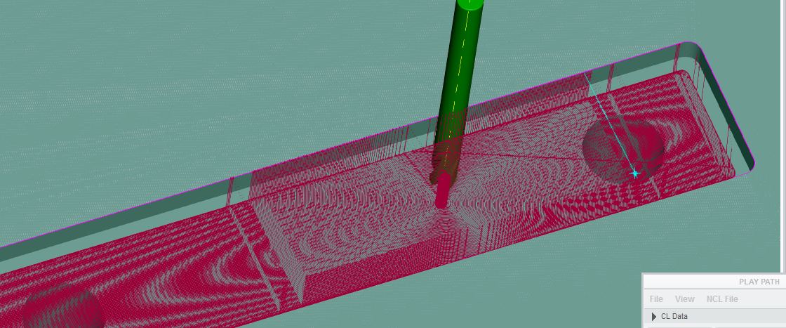

Been playing around with constant load in Creo 3.0 M040 and it has been working really good with those parameters but be careful with gouging. I have a case filed with ptc support case #12437221. PTC has been able to replicate the situation in M040 and M050. The work around so far, to prevent the gouging when the tool is doing a traverse move is to create multiple windows and try to keep the windows as simplest as you can and it will not gouge the part. I did not see the gouge until I ran it in Vericut lite. I can also send you the .mil for you to play with but then the sequence will not be driven by the tool and material.
The extra retract moves will happen sometimes and sometime work like a charm.
Jul 7, 2015 5:34 PM UTC
Todd,
Thanks for sending the Parameters. I see the difference now. You are using volume milling. I was trying to use the roughing sequence.works now!
I wish PTC would do a little more for us with tutorials or training for the new parameters and sequence options. Seasoned users of Creo are not going to take a class or get a subscription to PTC U just to get up to speed with the new stuff.
Steve
11-Garnet

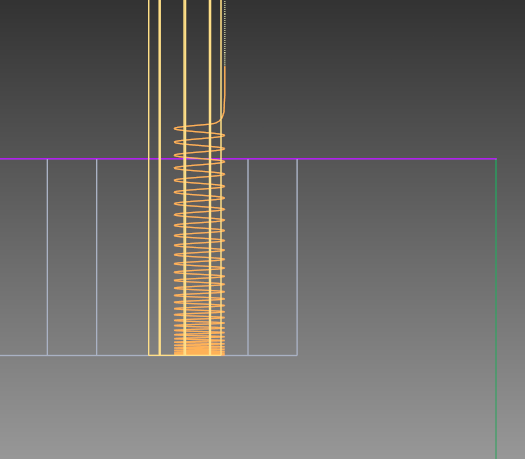

Mar 26, 2016 6:55 AM UTC
Dear Son,
I work with proNC and I try make a similar path.
I made the roughing or volumill and Helical entry always isn't constant.
Can modify this? Or it is a failure?
Jun 10, 2016 12:59 PM UTC
I believe there is a paramter starting in Widlfire 4.0 that lets you control helical entry.  I can get more info if you need it.
