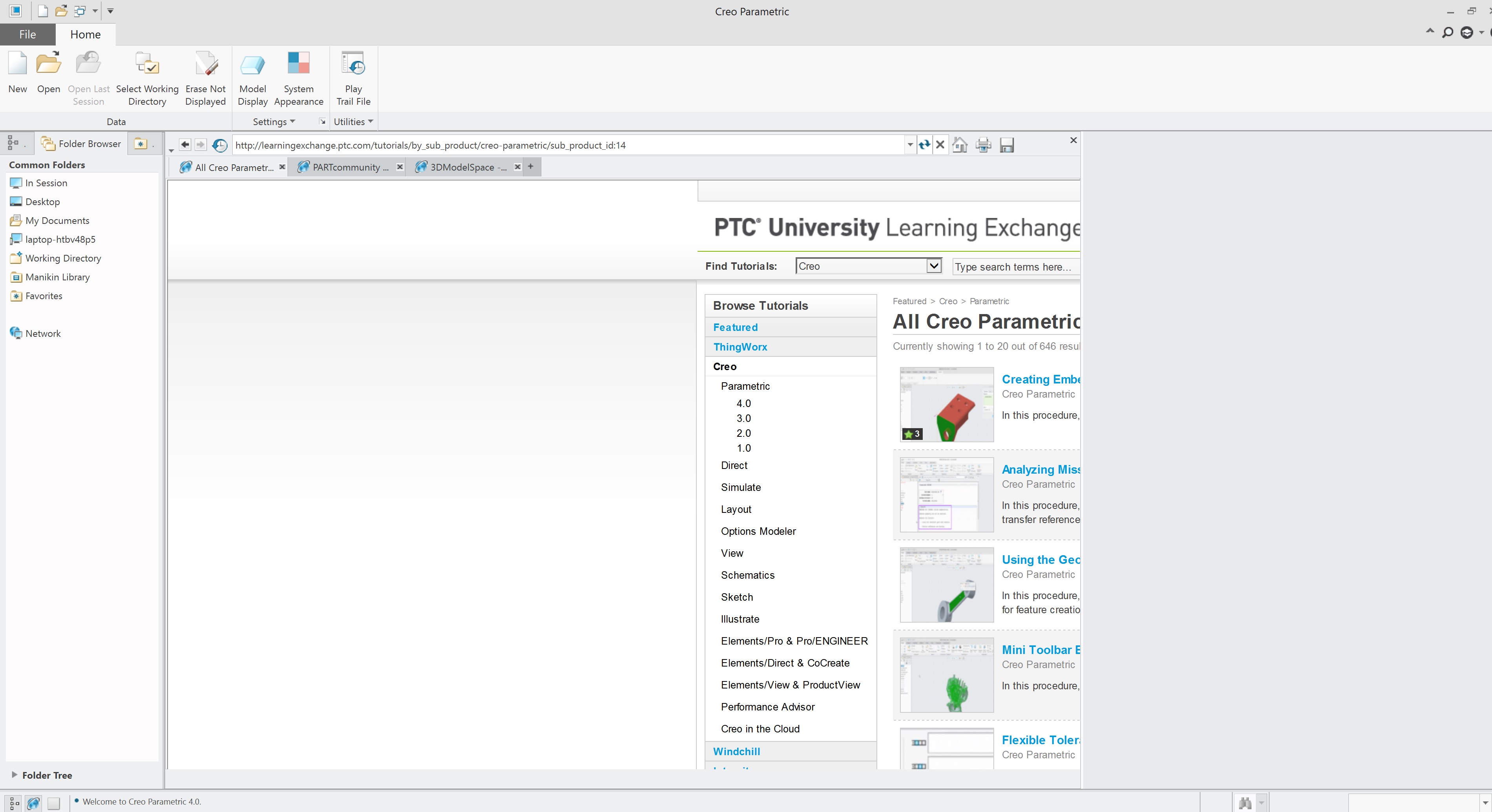

On a brand new install of Creo, I'm having an immediate issue with the embedded browser...
The contents of all tabs in the embedded browser are shifted to the right so that a portion is cutoff. Resizing the window only changes the amount of white blank space to the left of the content. I don't have Windchill setup currently to see if it is affected as well.
I've done some quick Community searches and haven't seen any similar issues posted in the past. I've also tried some config.pro modifications to see if I could fix it myself to no avail.
Thanks.

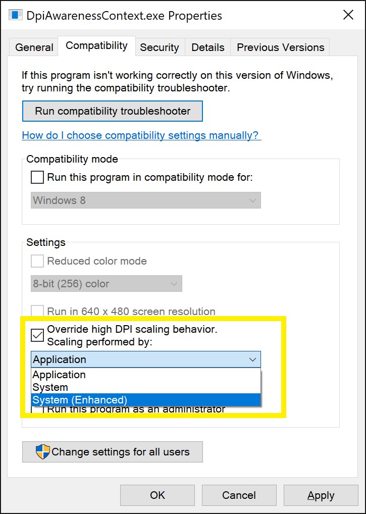

Set the override high dpi scaling behaviour drop-down in the application properties to "System".
This option is only present in build 15063 onwards (officialy released yesterday), for prior versions you have to do stuff which involves messing around with application manifest files.

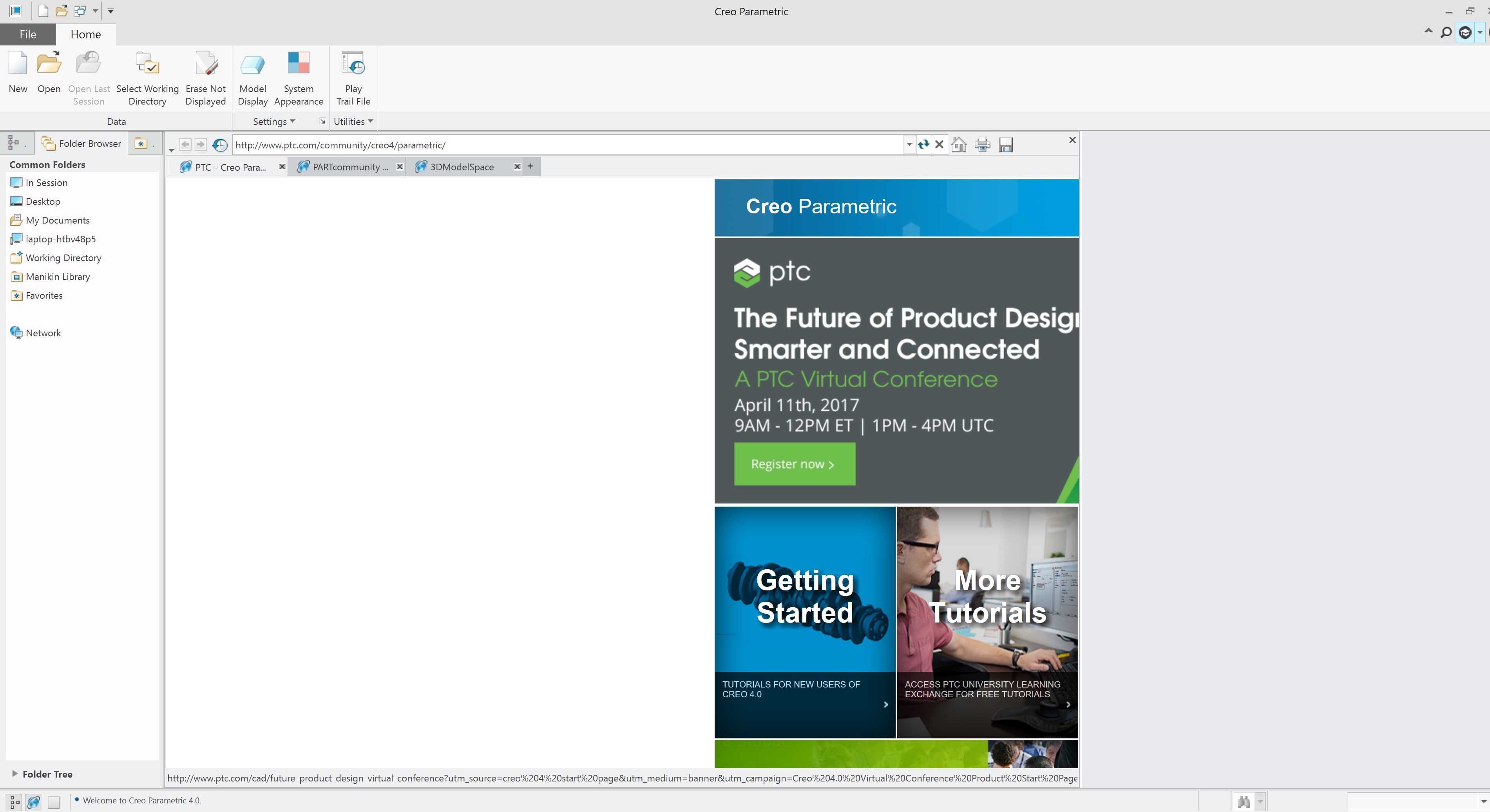

Just tried, didn't work. It doesn't really look zoomed in to me. It's like the HTML code is adding a large "filler" section. See below... the page header stretches all the way across....

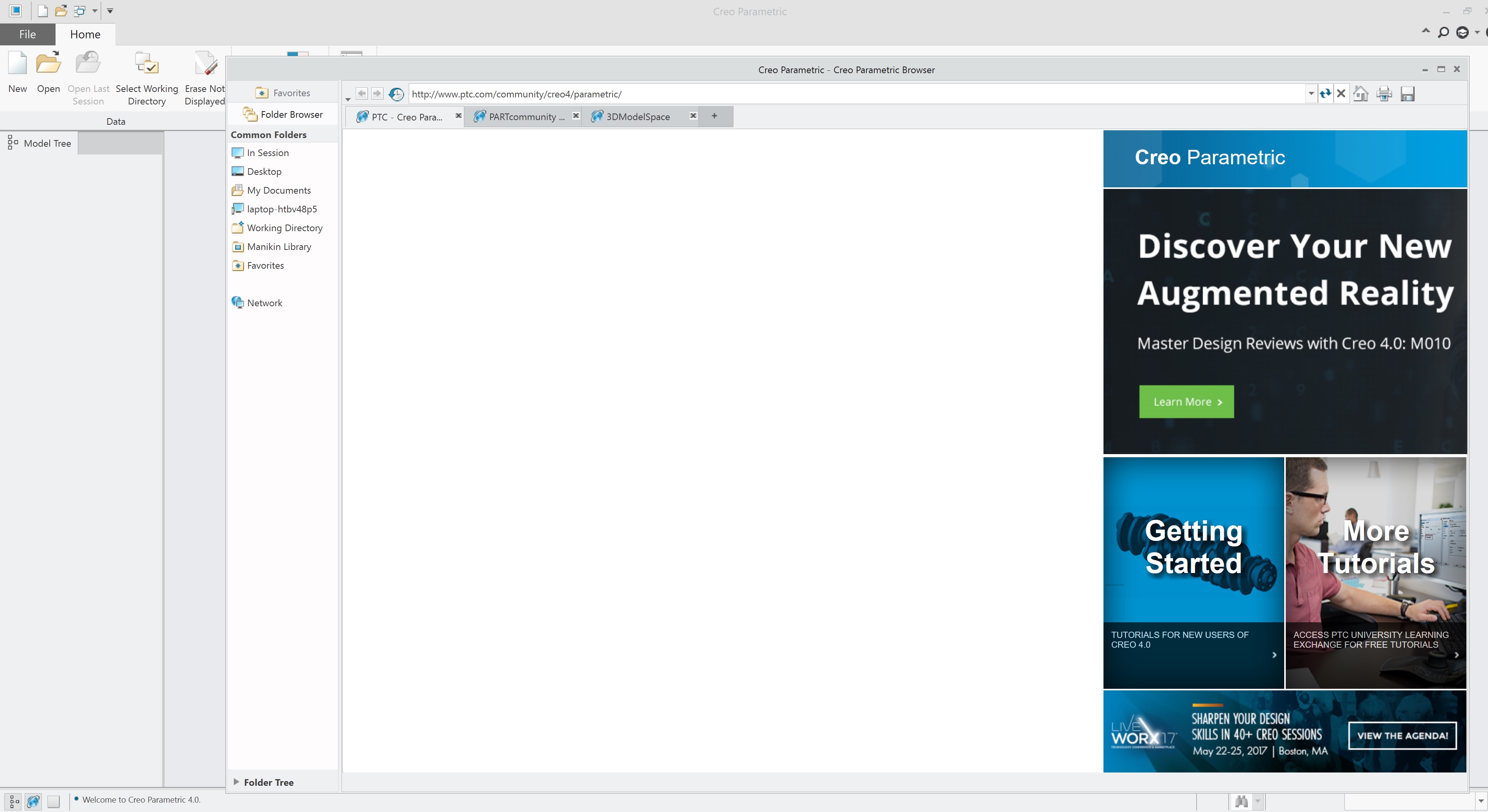

You could try having the browser in a separate window
web_browser_in_separate_window yes
jflynn1-VisitorAuthor
April 12, 2017
This sounds like it might be the issue (high dpi display). How do you force Creo to scale up?
The separate window didn't work ...
