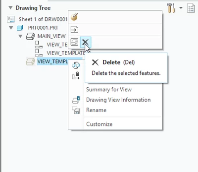

A detail view cannot have any of the names A, B, or C. When trying to delete the sheet, I get a message "Erased views will also be renamed." How to delete those views without deleting the sheet?
I remember a long time ago that there was a command that allowed me to select and delete those views, but I lost that cheat sheet when I changed jobs.
Does any of you remember it?
Thank you

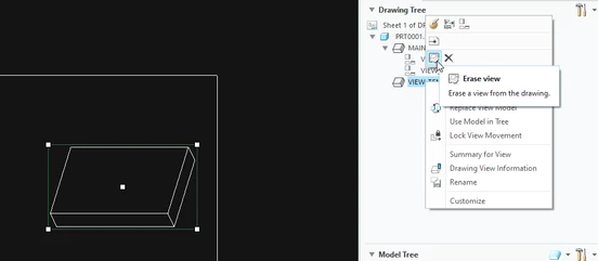

Please take a look at this article. I've run into the issue described in the past. Using the config option fix_draw_partial_del_bug fixed the issue.
https://www.ptc.com/en/support/article/CS38939

The problem is not deleting the model, but deleting erased views. See attached a sample. It is made using Creo 6
Dec 29, 2022 6:22 PM UTC
Are you able to look at the drawing tree? You can select views to erase and resume from there by picking the view. In my test, I can see the view if it's erased or resumed. I can delete it in either state as well. When a view is erased it appears as a hidden item in the drawing tree. I opened your example but didn't see any erased views on either sheet. Maybe I'm missing something?
