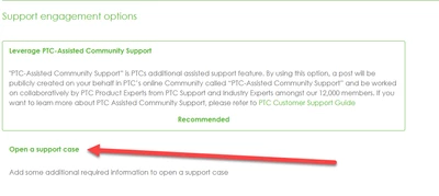

You've mistakenly sent this to the community instead of tech support. The community is generally not able to help with traceback errors.
Make sure you select "open a support case"
