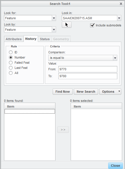

I have an error in my model. The error showed up while creating some tubing using the Piping application. I worked on trouble shooting it, couldn't figure it out. I deleted everything related, and couldn't figure it out. Unfortunately I worked on too many things to undo checkout and completely roll back to the previous version. I have completely deleted everything that was could have been related to the error. Attached is a screenshot of the error. The text is "ERR: internal datum 9713 of feat 9777 is missing". Neither this datum or feature exist anymore, but I cannot get rid of the error on regeneration.

Ctrl+F to search for the issue. Search by Name, and (the important part I didn't know before) switch to the HISTORY tab. Type your feature number into the Value field and select FIND NOW.
Your feature should show in the box to the left. It will not highlight anywhere in your model because it doesn't exist any more. Use the >> arrows to move it to the right side (which selects it). Now select Close to close the dialog box. Do no click anywhere else! Move your cursor over an open area in your model window and right-click. Select delete. This will most likely bring up a window saying it will delete highlighted features. If it does, select the Options button select all objects shown and change them to Suspend.
Another strange aspect of this...  you are still going to get the same error FOR NOW. If you search again for the same feature you will also still be able to see it. Save the model, close it, and Delete Not Displayed. Reopen the model and everything should be okay.

The find command should be able to find Feature 9777 using the feature number.

May 12, 2017
use ID option instead of Number option when searching.

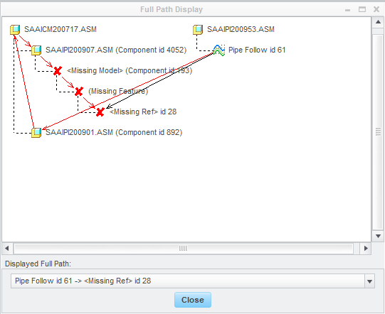

Try this config.pro option and have another look at the Reference Viewer afterwards.
The missing components/references should be marked with a dashed/dotted red line which can be deleted with right mouse click.
When I had this problem, I had to delete them twice w/ saving/regenerating.

I fixed my search and it finds the item, but it still doesn't show in the Model Tree (with no filters). I cannot figure out how to do anything with it.
We are running Creo 2.0 M170, so I changed the config setting (had to do in text file as option wasn't visible when searching for it).
Restarted Creo and option still doesn't show.
Reference Viewer only finds this.
This was unrelated, but I managed to fix it.
Still getting error and cannot find F18(Sketch_13).
