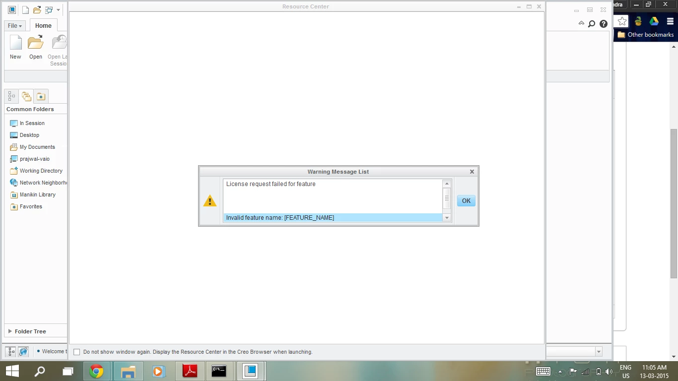

Hi there,
I installed creo 3.0 student edition first without using the lisense file. (by skipping it). after that, i installed the license file with the simple entry option. But i'm getting this error. Please help me out.
I've attached a screenshot of this.
March 13, 2015
license information is included in psf-file located in <Creo3_loadpoint>\Creo 3.0\Mxxx\Parametric\bin directory.
To create psf-file you can run reconfigure.exe located in the same directory.
The default file name is parametric.psf. This file contains following lines:
ENV=PTC_D_LICENSE_FILE-=PATH_TO_YOUR_LICENSE_FILE
You have to substitute PATH_TO_YOUR_LICENSE_FILE with real path.
ENV=CREOPMA_FEATURE_NAME=LICENSE_NAME ()
You have to substitute LICENSE_NAME with real name located on INCREMENT line inside the license file.

the complete text of an error message is written in std.out file. Upload it.

Hi, I did reconfigure the parametric.psf using reconfigure.exe. The content is as follows..
ENV=PTC_D_LICENSE_FILE-=C:\ProgramData\PTC\Licensing\BK400407EDSTUDENTUNICL_license.dat
ENV=CREO_APP=PMA
ENV=CREOPMA_FEATURE_NAME=CREOPMA_Student3 ()
and i think this is proper. But i couldn't find the std.out file. can you please tell me where to locate it?

std.out is create in Start in directory by default (see Properties of Creo shortcut).
You can also use Windows Search to locate std.out.

Got it.
Files reads as follows
License request failed for feature
Requesting CREOPMA_Student3 ...
C:\ProgramData\PTC\Licensing\BK400407EDSTUDENTUNICL_license.dat: (-8) Invalid (inconsistent) license key.
Displaying status for license file: C:\ProgramData\PTC\Licensing\BK400407EDSTUDENTUNICL_license.dat
License In Use Free Version Expire Date SCN
CREOPMA_Student3 Uncounted 34.0 12-mar-2016 Student3 Locked to: 84-4B-F5-DB-B2-4D
CREOLAY_Student3 Uncounted 34.0 12-mar-2016 Student3 Locked to: 84-4B-F5-DB-B2-4D
CREODMA_Student3 Uncounted 34.0 12-mar-2016 Student3 Locked to: 84-4B-F5-DB-B2-4D

Hey there,
It worked after reconfiguring the application. (not the one which was in the parametric folder). I used the setup file and opted reconfigure option in that. Then i selected all the applications in that list and viola, it worked! Thanks for help.
