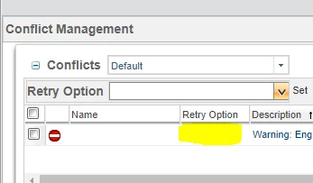

All,
Have you experienced the event manager not showing information regarding failed events? This is happening randomly and is starting to occur a few times a week.
Creo Parametric 5050
Windchill 11.0 M030 CPS14
PTC only has a workaround which is to rename the event folder in their cache and restart Creo, then try previously failed process. The workaround works but we need to understand why this is happening and if this is fixed in a newer build.

February 21, 2022
We're seeing the same issue with Creo Parametric 7.0 and Windchill 12.0.  The only solution we've found so far is to blow away the local cache as well.
February 22, 2022
For me, it didn't  work.
Issue is - no retry options found in conflicts, as attached below,.
February 22, 2022
Certain types of errors don't offer a retry option because retrying won't fix the problem.  What kind of error message are you seeing?
