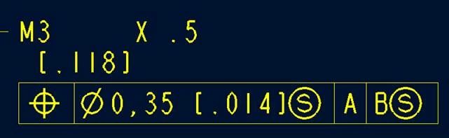

extra space when dual dimensioning
When we use dual dimensioning there is an extra space added that is not desired.
it should look like this " M3 X .5" instead it looks like "M3 X .5"
[cid:image001.jpg@01CDC703.5B284ED0]
Has anybody seen this before?

We are using Creo Elements Pro 5 m160....
Dec 1, 2012 12:16 AM UTC
Yes, it has to do with the font you are using. I couldn't get PTC to
open an SPR on it, maybe you can. You can either change font or usually
it is resolved if you "Stroke All Fonts" when you publish.
~Dan
Dec 1, 2012 12:24 AM UTC
Beware, "stroking all fonts" can create enormous PDFs

We are experiencing the same problem and I have yet to figure out how to correct it. We're bound by our "required" font. I'd like to think that I shouldn't have to change my font to fix it and instead it just shouldn't be there or be fixed, but I know that's too much to ask from PTC sometimes. We're using Pro/E Wildfire 5.0, date code M050. Does anyone else have these issues with, say, Creo Parametric?

Dec 3, 2012 5:10 PM UTC
I don’t think there is anything you can do about it. The secondary unit with brackets is taking up the extra space. Pro/E has always done that with any font I’ve used.
My question is why doesn’t it have a secondary unit call out for the thread pitch?

Dec 3, 2012 6:42 PM UTC
On a similar vein, PTC may not be totally weird here, not having a
correct format for dual dimensioning a threaded hole, as I would expect
there is no equivalent to M3 X .5 in Imperial (or US units) and dual
dimensioning should not apply. If I were inspecting an M3 x .5 thread,
I would have to buy an appropriate thread gage and have the cert list
the compliance in metric units.
I wouldn't expect some type of metric dual dimensioning for a
.500-13UNC-2B hole as well. 12.7-.511UNC(?)-2B(?) would be so bad it's
not even wrong.
