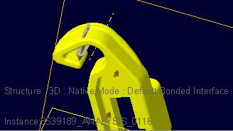

I was working on a Generic, entered Simulation, created some forces/constraints and ran a simulation.  I saved the file.  I thought I was out of simulation and found the Family Table grayed out.  I erased the generic from memory and called it up again.  The same issue of the Family Table is grayed out exists?
When I call up the Generic I am given the option to open an instance.
Does anyone know why this strange behavior is occurring?  Is there a solution other than opening each instance separately?
I am happy to see the forces/constraints carry over to the instance:
Once I opened the instance, the family table was available in the Generic.  Apparently the instances needed regenerated?
