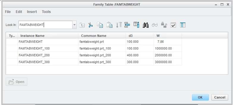

I am creating some new family tables of standard hardware items and 1 column is the weight of the item.
Currently, I am saving the generic file, then opening each instance and running our Mass Weight update mapkey to get the proper weight reflected in the instance parameters.
Is there a way to automate this so it is even faster than the 8 keystrokes it now takes. It isn't the keystrokes that takes time, it is the 300+ instances to be updated that does.

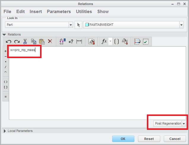

Then, using the post-regeneration area of relations, write the relation:
weight = mass:fid_Mass_Prop_1
I tried this - family table verification will correctly update "weight" in all the instances.

Verifying the family table should calculate all the Mass properties, and all other characteristics, for all the instances.
October 13, 2016
see attached part created in CR2 M070. Its family table contains column with parameter W. The value of parameter W is defined using post regeneration relation.

In order to have it in Post Regenration, do I put the relation weight = pro_mp_mass at the bottom fo the pro/program between the MASSPROP and ENDMASSPROP lines?

In Generic model define following...
MH

have added weight=pro_mp_mass to a post regeneration relation, but the values in my family table are not updating. I also added mass_property_calculoate automatic to my config.pro.
Even when I opened your sample file in creo 2 M160 and added a new instance of 50, it did not update the FT W column.

October 13, 2016
Thank you, Paul.
I just ran the verify on my 300+ family table and they all updated.
