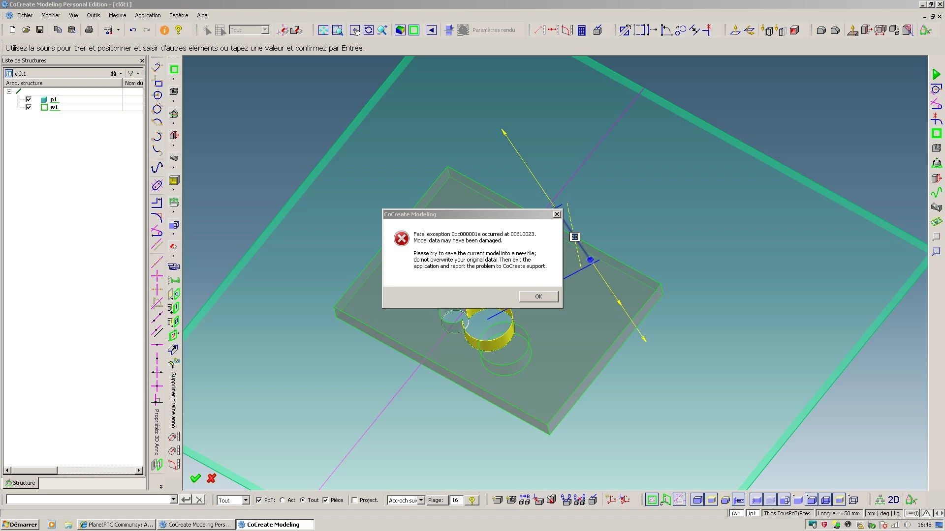

Fatal exception. Model data damaged in Cocreate3.0PE
I got a message about "Fatal exception"
You should find a pic about that and 2 files before and after that problem. I can't send it, I do not have customer support with ptc.

    In many cases, this particular error is triggered by a graphics problem. Is your graphics card on the approved list?
    FYI: Do not store your files as sessions. Store as .pk2, or if you have a model with a related drawing, store as .bd2
    Also, it is not necessary to zip your files. They are already compressed. Using zip will not make them any smaller.

    Thanks for your tips. I don't know if my card is okay: I have a NVIDIA Geforce 9500 GT 1 gigas video ram. Driver 8.17.12.6089 . It is not at all a professional graphics card....
    I will follow your mind about file type and zip.
