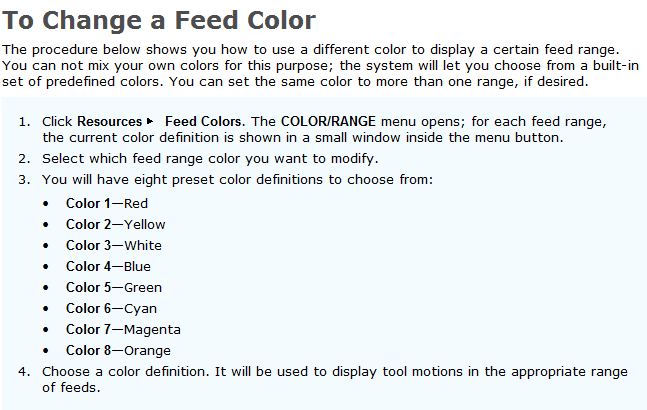

Does anyone know if it is possible to change the feed color in config.pro? I want to have the same colors for every new part I want to manufacture.
Aug 12, 2011 5:02 PM UTC
Sebastian,
I know you can change the feed color, but I don't see any config parameters to make them permanent.
