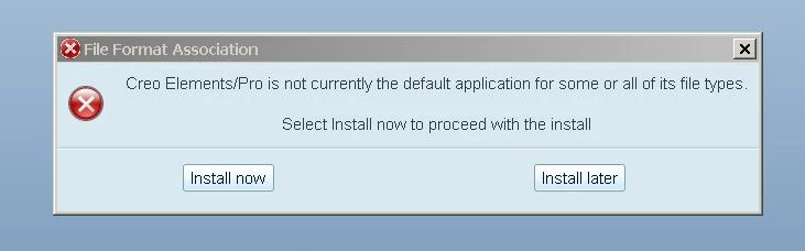

All,
After installing WF 5 M130 i keep get this message each time i open pro e.
is there any way to cancel it ? i know it is easier to install however i'm having issues
with my machine privleges.
any advice ?
Many thanks,
Rami
rnoah10-MarbleAuthor
April 25, 2012
setting the config option
"startup_check_for_visualization" to "no" solved the issue.
Rami
