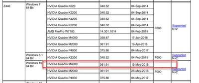

New development, I tested Graphics Win32_gdi option and surprisingly, file open was instantaneous.
After this problem started, I had updated my graphics driver to see if that helped, it did not. But disabling it completely does.
This doesn't bode well for my large assemblies, hmmmmm.
Any thoughts? Should I try older drivers and see if one of them works or should i ask for a new graphics card??

Not sure what Creo version or PC hardware you have, but you could start with the certified driver version that PTC tests against. Below is an example for Creo 4 / Dell:
http://support.ptc.com/WCMS/files/171727/en/dell_creo4.pdf
Note that if you upgrade to Creo 7 in order to use the Simulation Live and Topology optimization functionality you will need to use a newer driver as the "official" drivers that PTC supports do not have a high enough CUDA level to support those modules.

That driver is 5 years old. My computer is only 2 years old and scheduled for replacement at the end of this year (pending business circumstances).
I have asked my support guy to look in to the driver issue.
