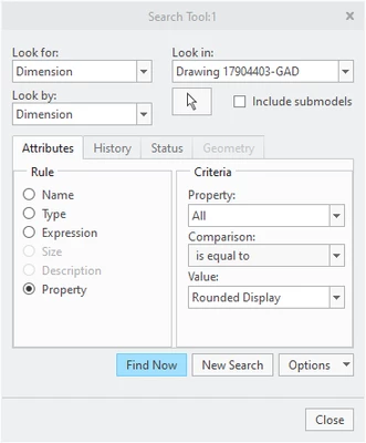

Requirements:
Have to find and rectify the Round off dimension values for example dimension value in drawing as 12.65 but in drawing round off value as 13 for the same dimension, Similar there are 400 number of dimension in the drawing. how to find those round off modified dimension values easily by model check or any solution of creo customization method for find this round off values.

Oct 12, 2022 10:41 AM UTC
Find tool:
