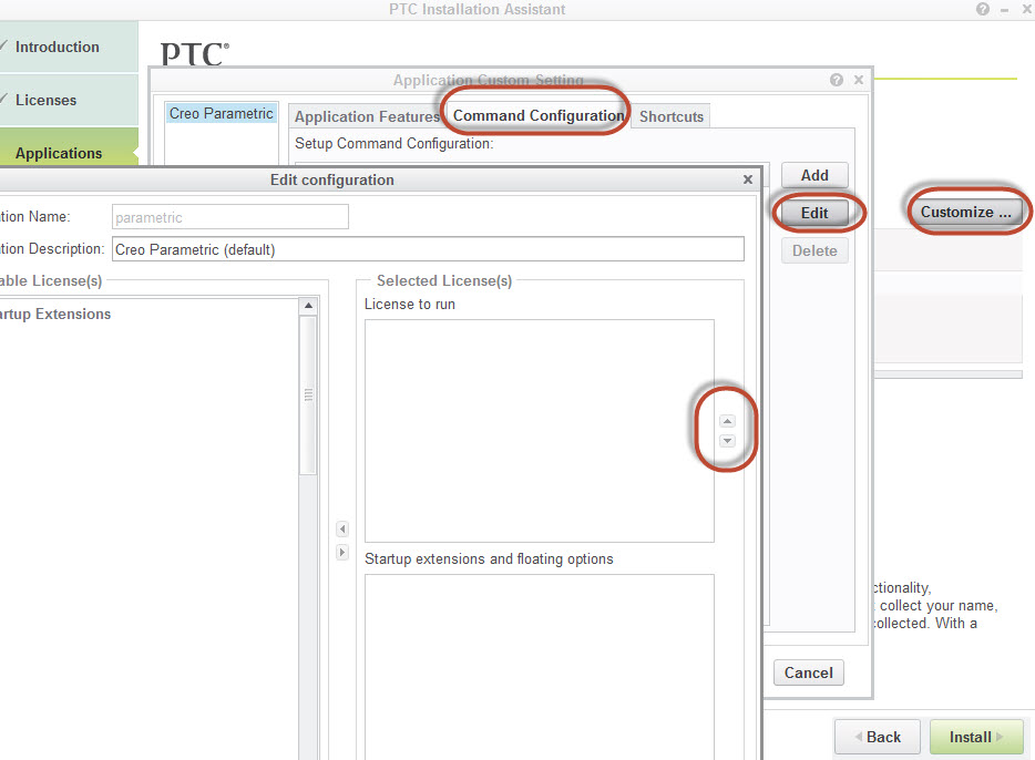

Mar 19, 2015 7:24 PM UTC
I think you would like to set the sequence of license in use, if this is correct, reconfigure Creo 2.0 using reconfigure.exe (<Install Location>\parametric\bin), Next > Next > Customize > Command configuration > Edit, here move the license up or down to define sequence.
