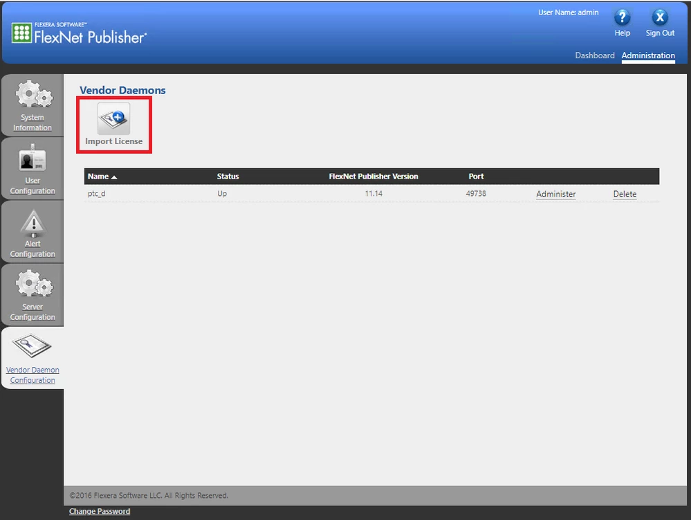

If I go the route of trying the "pure" flex install, I'll need to hand edit the license file I got from PTC to fill in all the particulars, like the ptc_d daemon locations, hostname and all that, correct?
December 7, 2018
No, you can just use the "FlexNet Admin Web Interface" from the start menu to import it:
If you have trouble logging into this page, stop the service and edit the server.xml file in the "C:\Program Files\PTC\FLEXnet Admin License Server\conf" folder.  Find the access control section near the bottom and replace the password for the admin user with whatever you want.  (It can be in plain text.)
Also realize there are two separate Windows services, one for the daemon (lmadmin_ptc) and one for FlexNet (FlexNet Licensing Service).  You may need to stop both of them if manually changing things like the XML file or the contents of the license.dat file.
