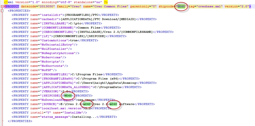

Some time-saving things I did were:
1. I edited each of the xml files from m050 so that I didn't have to reconfigure the software.
[cid:image001.png@01CE6C16.381E8E50]
