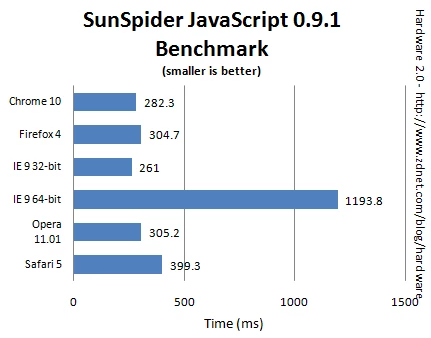

As an originator of this post, here is some feedback I got from PTC on
the issue:
(I'll have you know that when I used "Ignore font sizes', the font size
in my email (Outlook 2007) all became enlarged so I undid the setting.
Interesting about the 64/32 java though.
Hi Mark,
I saw your recent post and wanted to offer some suggestions.
First, I assume that you are using the default embedded browser
(windows_browser_type=ie_in_process), which uses the underlying Internet
Explorer engine. As an aside, since your platform is 64-bit, this will
also use IE 64-bit. Microsoft made improvements to their IE9 javascript
engine, but unfortunately only the 32-bit version. Set
windows_browser_type=ie_in_sep_process to use IE 32-bit in the embedded
browser.
See this Web Browser Comparison for Windchill:
Besides the Ctrl+MouseWheel approach, Ctrl+ (+ or -) changes zoom using
keyboard. Ctrl+0 (zero) resets to default.
Font size can also be affected via Internet Explorer Options.
Launch standalone browser, go to Internet Options > General tab >
Accessibility button.
Enable "Ignore font sizes..." to bypass Windchill style sheets.
Note that this may cause pages to render with various text overflowing.
Hope that helps,
