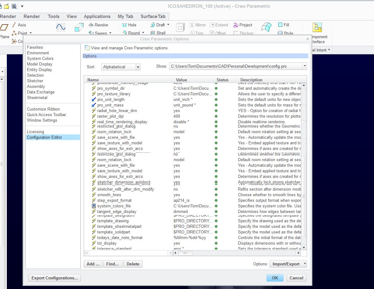

Jan 27, 2013 11:43 PM UTC
Well that was short lived!
The dialog for the config.pro options was completely unusable. Somehow the graphics won't keep up as you drag the slider. Also get a lot of "black zones" when changing the vertical size of the window. How annoying! This is on my Dell Precision 6600M and your platform may behave differently.
Back to the drawing board!
Jan 28, 2013 3:01 AM UTC
I decided to get bold and load the latest Dell version of the NVidia Quadro 3000M driver. It is not 296.79. This one is more stable than the NVidia version from the site. Dell must be doing something to make it compatible with their system before releasing it.
I get no artifacts on the config.pro screen and it recognizes the Creo 2.0 application. The files I had trouble with are behaving.
The original driver Dell included was actually for the Quadro 2000M. It was version 268... something. I forgot to note the version.
I did test running the maximum graphics settings and all went well.
