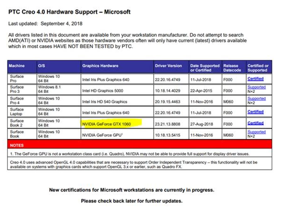

    February 1, 2019
    February 1, 2019
    GeForce used in MS Surface, not workstations or workstation-class laptops!
    Read Note 1 below the chart.
    Like I said 9 years ago, they will work BUT you will not be getting optimal performance and the number of files you can open may be limited.
