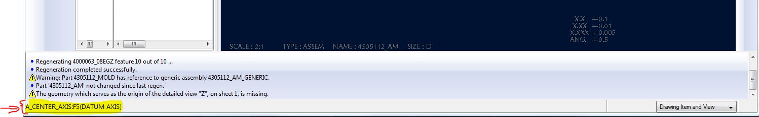

    I have been using this since Charlotte Halstead‌ pointed it out and it is very useful!  I have set it up with other people in the company too.  That being said, I wish PTC would make it so it doesn't overlap with the message log text.
    E.g.
    Perhaps PTC couldn't figure out how to easily avoid this overlap so they just turned it off by default...?
    Don't get me wrong though, I am VERY glad that we can still turn it on and use it, even if it has the overlap. (I.e. PTC please don't remove this functionality! but if anything perhaps polish back to WF standards )
