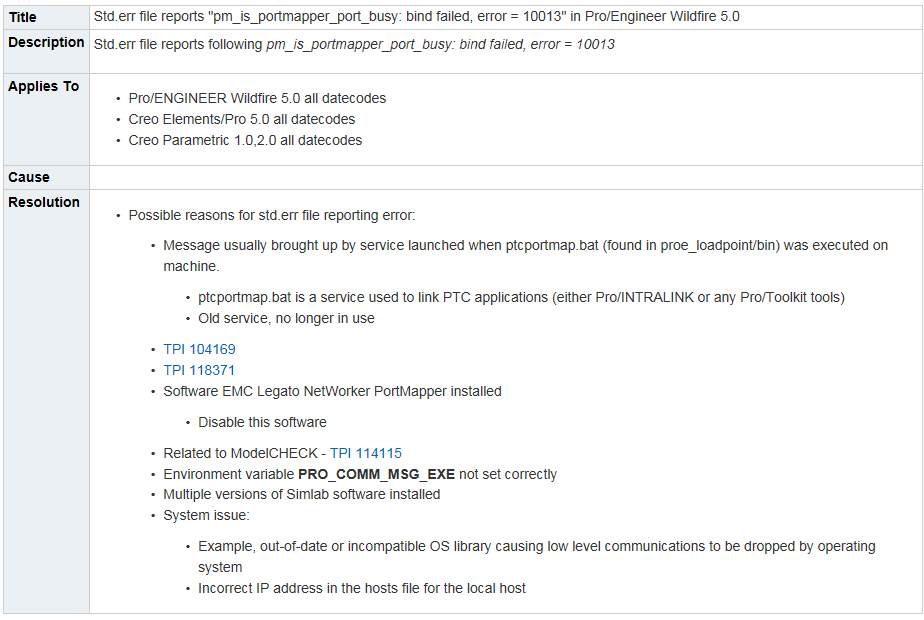

In the last two days, when ever I go to save, it takes a really long time and then it crashes.
Looking at the std.err output, I have two lines that both read:
pm_is_portmapper_port_busy: bind failed, error = 10013
Any thought as to what may have changed to cause this?
Thanks, Dale
    Dale_Rosema
    October 6, 2015
    Somehow the .idx file got deleted.
    Once this file was restored from backup. WF5/Creo acted fine.

    I just found this:
    What software do I need to disable?
    Thanks, Dale

    In the std.out, I am getting the following message:
    ERROR - G:\Engineering\PROE_DATA\A_A_Proengineer\config.pro, linenum 2 :  Keyword 'USE_8_PLOTTER_PINS' is not valid.
    ERROR - G:\Engineering\PROE_DATA\A_A_Proengineer\config.pro, linenum 4 : Invalid value '1' for keyword 'POSTSCRIPT_LEVEL'.
    ERROR - G:\Engineering\PROE_DATA\A_A_Proengineer\config.pro, linenum 7 :  Keyword 'CADAM_LINE_WEIGHTS' is not valid.
    ERROR - G:\Engineering\PROE_DATA\A_A_Proengineer\config.pro, linenum 11:  Keyword 'SKETCHER_DEC_PLACES' is not valid.
    Would any of this cause it and if so, how do I fix them.
    Thanks, Dale
    October 6, 2015
    The first should be USE_8_PLOTTER_PENS.
    The others I'd comment out in your config (use ! for a comment line) or remove them, however I doubt they are your problem.
    Have you read through the TPIs listed in that KB article?

    January 11, 2017
    I am having similar issues with crashes on every save that started yesterday afternoon, but the .idx file was not deleted this time.
    Is there a way to recreate/redevelop this file from scratch. I am trying to figure out if it got corrupted somehow?
    Dale
    January 12, 2017
    file named directoryname.idx can be deleted anytime. Its only purpose is to display family table instance names in Open dialog box. You can recreate the file using File > Manage Session > Update Index command.
