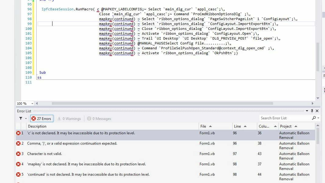

I have created a MAPKEY to choose a config file from the Working Directory. Its working fine in manual mode.
Now i have added this mapkey to a Button Function. What actually the button will do is it will launch the CREO first after that it should run the mapkey to select the config file.
Launching CREO is working fine but its not running the macro.
Should i declare anything before i call the function " IpfcBaseSession.RunMacro" when i went through the VB-API document i didnt find any such thing.
Below is my CODE and ERROR Message.

For error message please see the attached image.
Kindly help me to solve this issue.

I'm only familiar with J-Link, but the API looks similar. Maybe it even follows the same rules. Try the following for the RunMacro(..) method:
IpfcBaseSession.RunMacro("Close `main_dlg_cur` `appl_casc`;~ Command `ProCmdRibbonOptionsDlg` ;
                                    ~ Select `ribbon_options_dialog` `PageSwitcherPageList` 1 `ConfigLayout`;
                                    ~ Select `ribbon_options_dialog` `ConfigLayout.ImportExportBtn`;
                                    ~ Close `ribbon_options_dialog` `ConfigLayout.ImportExportBtn`;
                                    ~ Activate `ribbon_options_dialog` `ConfigLayout.Open`;
                                    ~ Trail `UI Desktop` `UI Desktop` `DLG_PREVIEW_POST` `file_open`;
                                    @MANUAL_PAUSESelect Config File..........;
                                    ~ Command `ProFileSelPushOpen_Standard@context_dlg_open_cmd` ;
                                    ~ Activate `ribbon_options_dialog` `OkPshBtn`;")
Be aware that i have no idea how to concatenate a string in VB and also I'd think you cannot put a @MANUAL_PAUSE line into the macro. I'd replace it with regular UIShowMessageDialog(...) instead if there is such a thing in VB API, and split the whole thing into two RunMacro(...) methods.

May 19, 2017
Hi james,
Thanks for the reply. it solved my problem.
