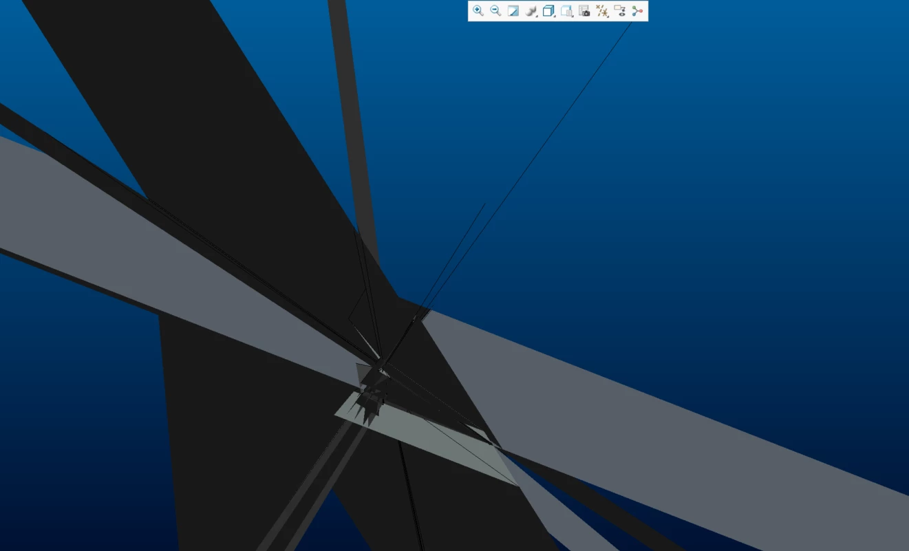

Graphic bug
I am using Creo Parametric Release 4.0 and DatecodeM070
When I opened the 3D model, particularly complex in shape, it ended up resembling radiation or an explosion, making it unusable. What could be the cause of this issue? Could it be due to insufficient specs on my computer? Please help.

open config.pro in Notepad and add following option at the end of the file:
graphics  win32_gdi
Start Creo and open your model. Is graphic display OK?

There is a config.pro in each of the following files.should i change them all?

@WW_9736399 wrote:
Thanks.
WW
in my installation it is file:
E:\PTC\Creo4_M080\Creo 4.0\M080\Common Files\text\config.pro
In your installation it is probably file:
C:\Program Files\PTC\Creo 4.0\M070\Common Files\text\config.pro
Michael
February 16, 2024
You should update your graphic card driver.
Last resort mentioned to force GDI but your system should be able to leverage the GPU. What hardware are you using?
