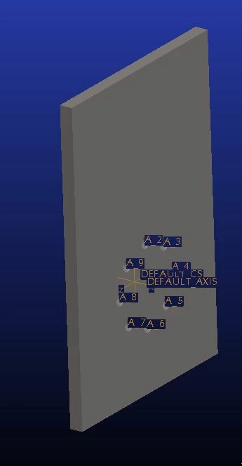

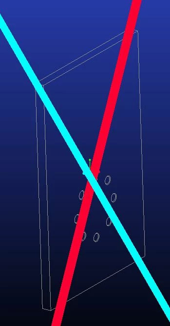

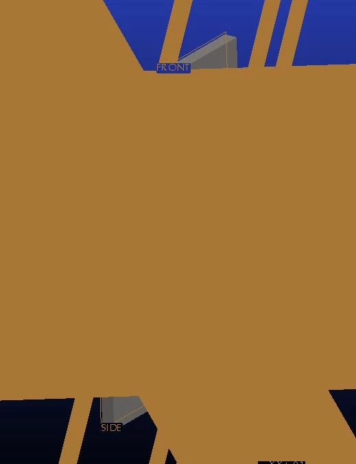

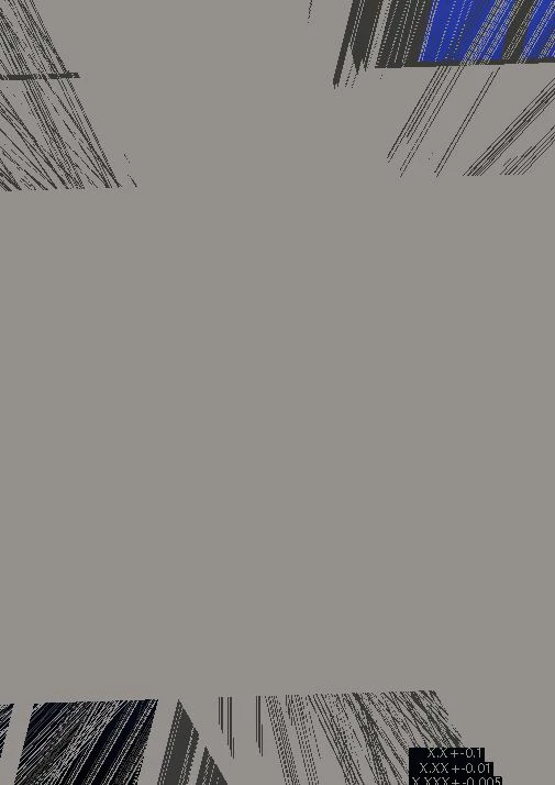

We have an internal training lab equipped with 6 PCs that we use for a variety of purposes including our periodic internal training for Pro/E. Last year we replaced all the PCs with new hardware running Windows7 Pro (64 bit). The hardware configuration isn't PTC certified, primarily in that it uses the basic on-board Intel Graphics chipset (B43 Express ) instead of our normal certified Nvidia card we get on the Dell T3500s provided for daily use to our Pro/E users. Then again, our current path of all new PCs running Wildfire 3 M250 and Intralink 3.4 M030 on Windows 7 isn’t supported either, but it works after a couple of tweaks to get us through migrating to PDMLink and WF4 or 5 later this year. The PCs in the training lab were working fine with all apps, including Pro/E, until last week. Now graphics in Pro/E exhibit serious issues when models are viewed in hidden line mode or if datum planes or the spin center are displayed (see attached screen captures). The only thing we are aware of that changed is the automatic application of standard Windows updates from Microsoft. We are in the process of removing Windows updates from the last week to try to determine which one, if any, caused this issue. I’ve already tried changing the Pro/E graphics setting from opengl to win32_gdi and setting compatibility for Pro/E to Vista and didn’t get any improvement in the graphics (win32_gdi made it worse). We may end up installing Nvidia cards in all these PCs, but for as often as they are used for CAD and the fact that they were working fine a little over a week ago leaves me wanting to know what happened. If anyone has seen this before or has other ideas on what to check, let me know. Thanks!
