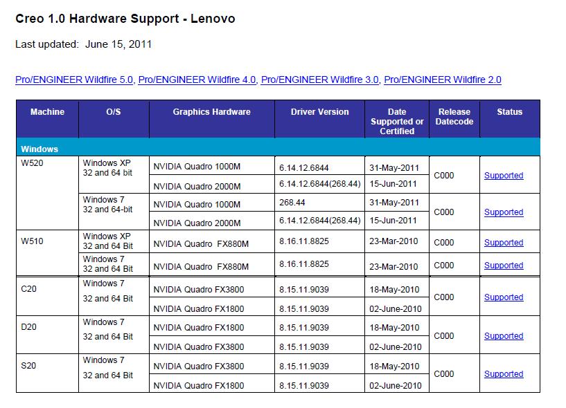

I am unable to find an updated driver for this excellent laptop from lenovo. It has an ATI Mobility FireGL V5700, which works excellent with Wildfire 4.0 and Windows 7 64 bit.
The issue is that when I open a second model/drawing/any pro/e window 1/5 of the window on the right hand side turns negative (like a picture negative,). It is black background and all of geometry is a bluish purple in that area. Any additional windows that I open have this issue.
Wondering if anyone else has run into this on other makes and models of laptop or work station.

And here you can find Creo 1.0 Hardware Support by Lenovo: http://www.ptc.com/view?im_dbkey=127697
November 17, 2011
Latest Graphics driver appears to have addressed the issue. After this latest graphics driver update I have been unable to get the issue to reproduce.

Wow they make replying way harder than it should still not sure how I got the reply button to finally appear. Peter I am unable to help you with this one. We have replaced our w500 with the w520. the w520 is not showing this issue.
David
June 28, 2012
David,
Thanks for your quick responce. I have come to the same conclusion. We will replace the w500 with w520 with Nvidia graphic card as well.
