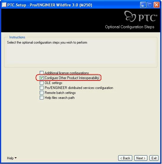

Dear all,
whats meaning with this message on GS status monitor (during publishing):
... ERROR:CadAdapter.ConvertCadFile failed Error: $Error$ Bad Input to ProWorkspaceRegister [5148064]
Publishing stops promptly!
System runs under
Windows Server 2003
Standard Edition
SP2
IIS Version 6.0
ILink 3.4 M62 MS
WF 4 M40
GS M100
Thanks for any help!
Ralf
    July 14, 2011

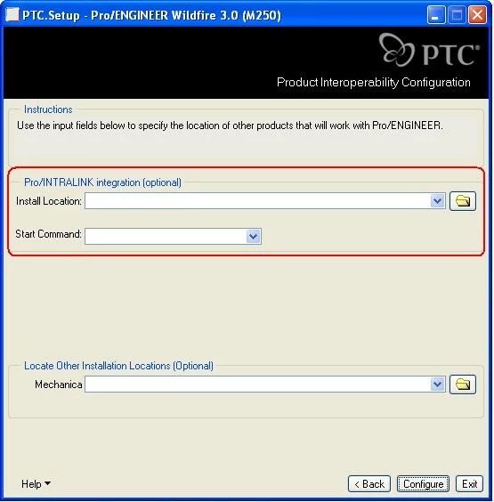

    Hey Ralf,
    Seems like The *Pro/ENGINEER* installation is not interoperable with the
    Pro/INTRALINK client. To make it interoperable:
    1. Run ptcsetup.bat from the <pro engineer=">/bin loadpoint
    2. In the "Optional Configuration Steps" screen, select the option "Other
    Product Interoperability"
    3. In the "Product Interoperability Configuration" screen, Enter the
    Pro/INTRALINK integration information.
    After ensuring the above steps, restart the CAD worker and publish the files
    again.
    Note : The screen prints and the proceadure above is for Wildfire 3 (Didn't
    have time to down load and check for WF 4). You must look for somthing
    parallel/simillar when using Wildfire 4.
    Let me know if that works for you.
