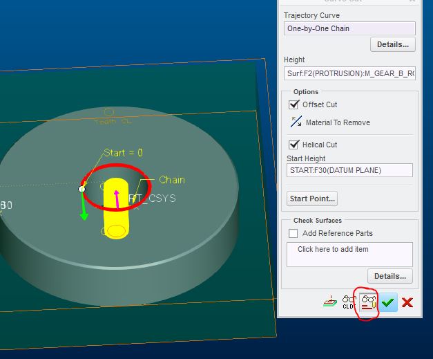

I do quite a bit of helical trajectory milling but since updating to creo2.0 M110 the helical milling is quite slow calculating the tool path. At the bottom of the curve cut menu there is a button that you can turn off that is for viewing toolpath updated for every modification. When you turn this button off it speeds the calculation up. This button is always on when you open trajectory curve.
The question that I have is there a way to turn this off when i open trajectory curve until I want to use it ? I looked through the config options, but there seems to be none for trajectory milling.

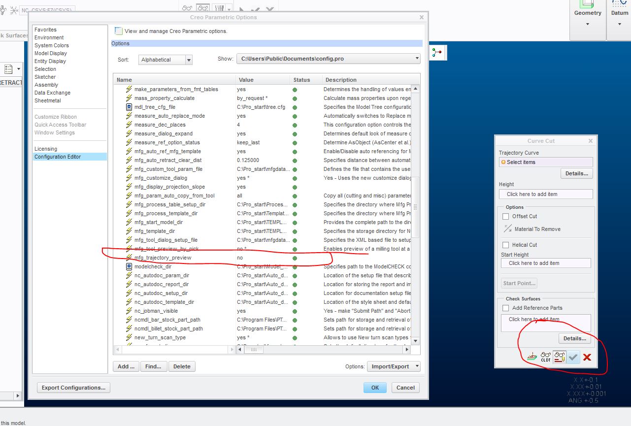

I also looked on Olaf Cortens site at the config options that are hidden. There is one that looks like it is for just what I am asking about but when typed into the config it doesn't allow me to add it(mfg_trajectory_preview).

I fear the defaults are hard coded and cannot be changed. For reference, I created an article in our database with all the information I could find: http://www.ptc.com/appserver/cs/view/solution.jsp?n=CS176615

Type mfg_trajectory_preview no into the config.pro using a text editor. Save the config.pro and either restart Creo or go to the config.pro in Creo and import the your edited file.
Jul 11, 2014 11:28 AM UTC
Thanks Dave,
Tried but It didn't work I wish it did because that is what I am looking for.
