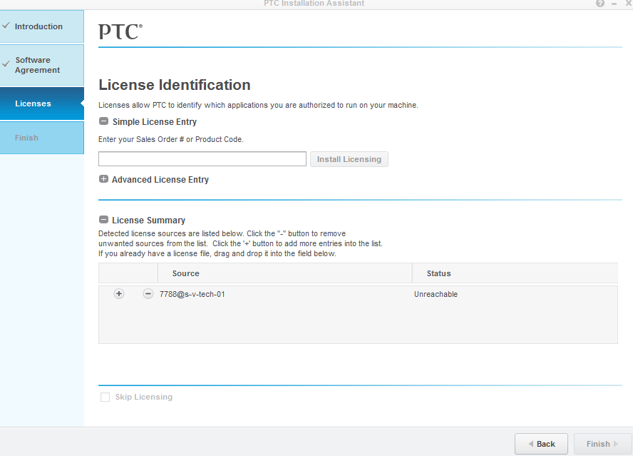

Hello , i have installed creo 3 license on a server but when setting up the client with 7788@s-v-tech-01 i get the status unreachable. The firewall is turned off on the server. i am at a bit of a loss to understand why it's not communicating. Any hel
Hello , i have installed creo 3   license on a server but when setting up the client with 7788@s-v-tech-01 i get the status unreachable. The firewall is turned off on the server. i am at a bit of a loss to understand why it's not communicating. Any help would be great. thx

go to license server and define windows firewall rules that enable inbound communication for lmadmin.exe and ptc_d.exe processes. These files are part of FLEXnet installation.
For testing purposes, you can turn off windows firewall on server temporarily.

Hello Andrew,
Check if the Flexnet License service is started on license server.  Also always give fully qualified hostname while installing the application. Refer to PTC Article CS60089 for more details.

Hello Andrew,
This is the common issue in Creo 3.0 license server when license is floating.
The best way i found to resolve this is to use the older version of license server.
->Uninstall the current license server from the creo server and download the old WF license server (Flexnet license server 10) and install it.
->After installation of license server is done. Reconfigure the Creo apps on client machines.
This will definitely work.
