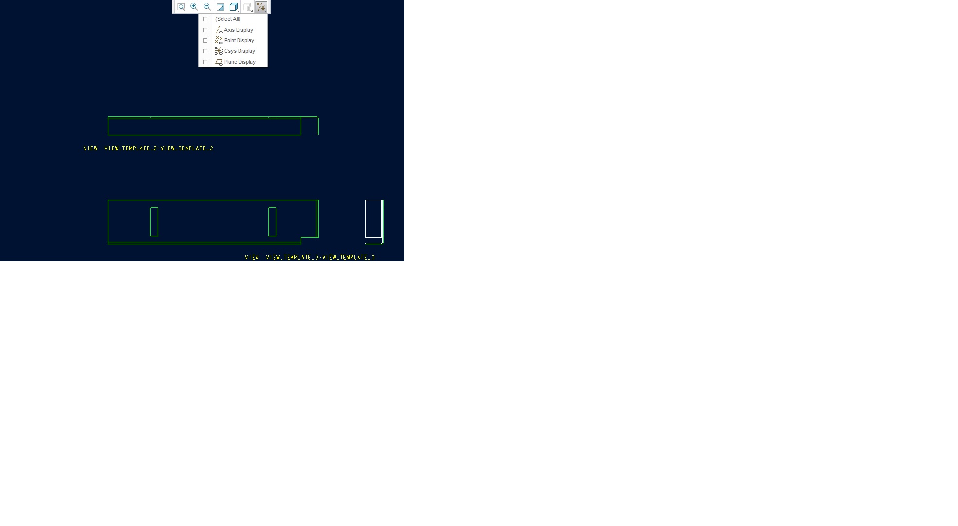

hidden: axis and points and csys as default
parameter to hidden axis , csys and ,points in 3d and in 2d
i want to make this with config sys
it is posible?
tks

Go to FILE - OPTIONS - select the tab for ENTITY DISPLAY.
Uncheck the boxes for SHOW DATUM AXIS, SHOW DATUM COORD SYS, SHOW DATUM POINTS.
Push the OK button at the bottom and push YES to the dialog box that asks if you want to save your configuration settings and accept the default location to save the file.
