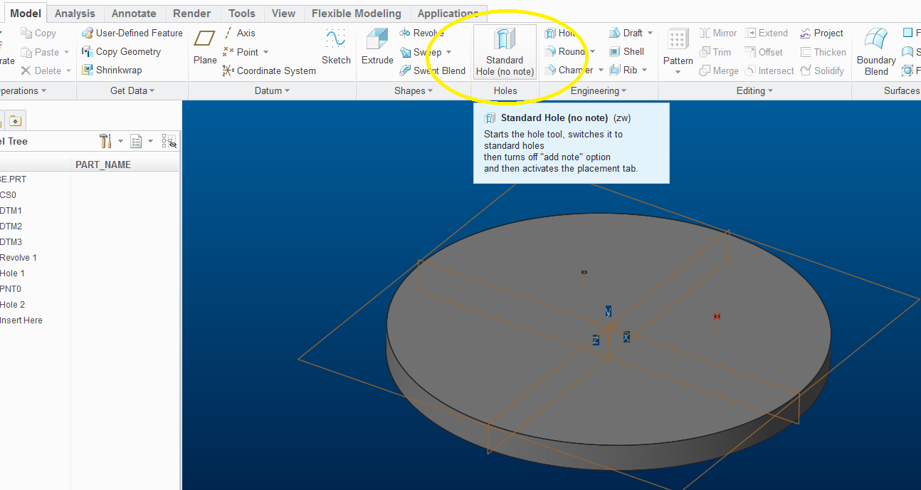

Consider using mapkeys for automation of all such repetitive tasks.
It is very easy and quick to define them (file->options->environment->mapkeys settings).
Also keep in mind that you can add the button that calls this mapkey right next to the standard "hole tool" in the ribbon.  If you are dilligent
when documenting this mapkey as you define it, then the popup-help texts will remind everything for you in the future times:
This is the actual code that you would save to your config.pro:
mapkey zw @MAPKEY_NAMEStarts the hole tool, switches it to standard \
mapkey(continued) holes\nthen  turns off "add note" option\nand then activates the placement \
mapkey(continued) tab.;@MAPKEY_LABELStandard Hole (no note);~ Command `ProCmdHole` ;\
mapkey(continued) ~ Select `main_dlg_cur` `maindashInst0.ui_str_skt_std_type_rg` 1 `Std`;\
mapkey(continued) ~ Activate `main_dlg_cur` `chkbn.std_hole_note_layout.0` 1;\
mapkey(continued) ~ Activate `std_hole_note_layout.0.0` `PH.AddNoteCBut` 0;\
mapkey(continued) ~ Activate `main_dlg_cur` `chkbn.hole_fb_plcmnt_page.0` 1;
(Creo 3.0)

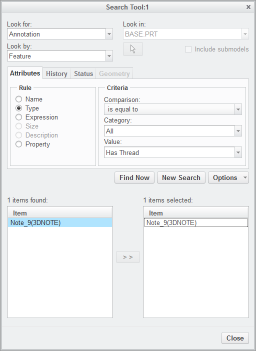

In re-reading this thread, perhaps I misunderstood what you are asking.
If the intent is to manipulate already created hole notes, then use the "Find" tool (CTRL+F):
The rule shown above will collect all notes in the model.  After you transfer the notes found to the "selected" section and close the find tool, you can right-click in the graphics area and either hide them, or delete them...
