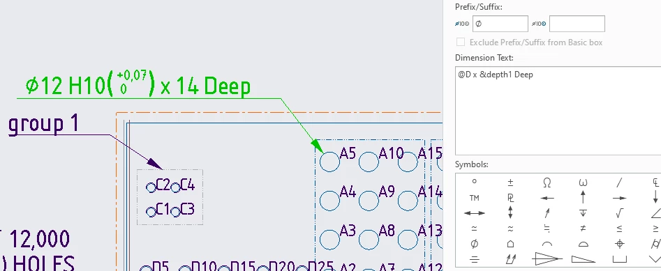

I have created a block which has multiple simple hole.
but when I tried to get the depth of simple hole in hole table , I am not getting any parameters to add to hole table format.( But If i create a any standard other hole ,I can see multiple parameters BUT NOT FOR SIMPLE HOLE)
How can I add a depth of multiple simple hole in hole table with help of parameter's

Create parameters (say depth1, depth2.....) for different depths.
Assign the parameters to the required depth.
Call the parameters in the hole table.
Personally, I do not like this method. I would rather have the hole table without depth, Group the different depths with a Phantom Line, take a section and show. Alternatively, use a parametric note with arrow that includes the depth.
