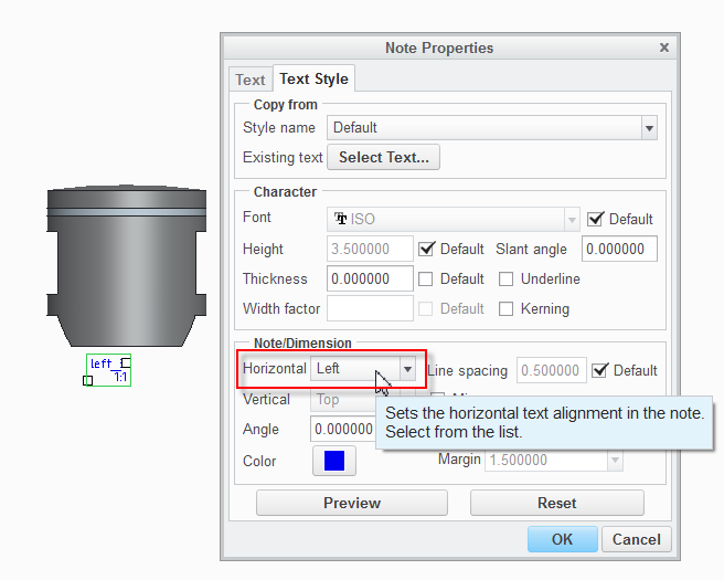

I' ve got a question in drawing. Is it possible to make default text alignment in horizontal text to be set to left. In my case is currently set to right.
For better understandig I'm adding some pictures:
I would like that this alignment would be as a default set to left.
Is there any command in config that would set this?
Thanks in advance!

From the pictures it looks like those are view labels. If this is the case in drawing properties you need to set the "default_view_label_placement" to bottom_left or top_left.

Yes they are view labels/view notes. Command "default_view_label_placement" just changes the position of the view label. I wish to change the alignment of the text in this label. So i would like to have:
- view lable placed bottom left
- alignment of the text in this view lable set to left - by default
