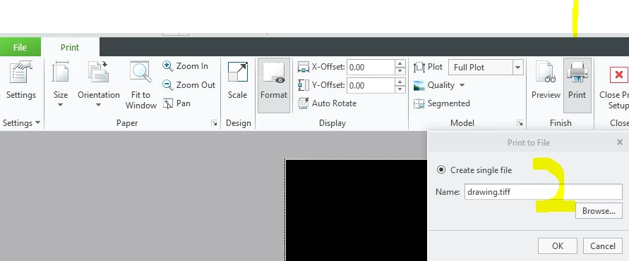

See image below. Once you have setup your TIFF printer, you should click on the print button and then there will be a dialog box where you can set the location and change the file extension.

File -> Print -> Print -> Settings -> + arrow down symbol to the right of the printer -> Add Printer Type -> Scroll to bottom and add TIFF -> Change destination to file -> Click Print Button -> Click Browse button and set the folder location -> change file extension to TIFF in the path -> Click OK

I added TIFF in the Printer but the extension comes as  .plt and I can't change it.
There is no other option available in the dropdown.
